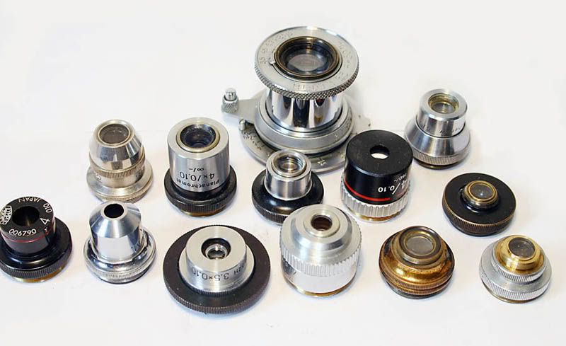

I bought this lens long time ago as part of a microscope parts lot, but never used it as it was designed for microscope large format photography. I also DIY a lens mount with helical for using microscope objectives as photograpy lenses on my OM EPL-2 as I have many low power 2,5x-4x microscope lenses. These are tiny and light so that they are easy to carry around.
