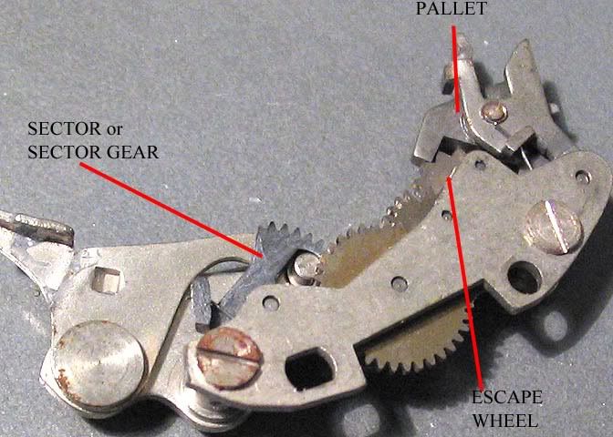

I suspect a broken or dirty escapement....All speeds are slowed by this, if hung it will only give top speed, clean or replace escapement
escapement=clockwork mechanism that controls slower speeds <30.

A small gear train that slows speeds down...
