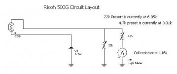

Hi, I just re-open my 500gx to see the adjustment screw, i see 2 potensiometer near wind lever area, are there any clue about these ? Are there any way to calibrate metering system to accept LR/SR44 type battery (1.5V). i assume 500G and 500gx is the same.
Right now I use one LR44 battery and I need to adjust iso ring to 400 for iso/asa 100 film.
Advice please..Thanks!

Great man !! I'll tweak my 500gx tonight, let's see if I can recalibrate it for 1.55V LR/SR44, I think by lowering 22Kohm pot, it will draw more current so the meter (hopefully) get the same current. 4.7Kohm then use to set linearity..just quick though..let see ..
Thanks a lot Nickon51!!
