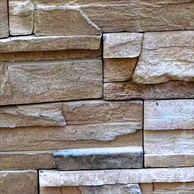

I decided to create three different reference shots to be used for the GW3 comparisons.
- Fuji XE1 using 14f2.8
- Sigma SD1M using the 10-20f3.5 Zoom at
-- 14mm
-- 18mm
All shots taken first wide open and then at f5.6. Center crop and crop of far left edge. Auto white balance on all cameras. The day I shot these images was a cloudy overcast day. The SD1 color balance turned out to be the closest.. The Fuji and Ricoh were a bit warmer.
This is my normal I know your tired of it back yard retaining wall I always use to check things out. All shots were hand held. Yes if I did this with a tripod, it would be sharper, but my normal shooting is always handheld. All shots were about 10-12 feet away. These are all reduced size jpgs designed to fit in 1024x1024. The RAW or TIFF16 files show much more details. The comments that I am going to be making are based on what I see from Aperture using the RAW and TIFF16 files.
First the overall wall shot from the Fuji XE1 14mm @f5.6
The SD1M @14mm f5.6 next
The SD1M @18 f5.6
Look at 100% center crop of Fuji at 2.8 and 5.6
Now lets look at 100% center crop of the SD1M 14mm at 2.8 and 5.6
The 100% center crop of the SD1M 18mm at f2.8 and 5.6
The shots from the Fuji are not too bad, they are a bit warmer compared to the Sigma shots. The Sigma is closer to what it should look like, but it does have a bit colder color cast. Given the cloudy overcast day, this is to be expected.
The Sigma shots at f5.6 all show much better fine detail then the Fuji shots. To keep things simple, I will use the Sigma shots as a reference for the GR and the DP shots and only concentrate on the center 100% crop from this point on when doing the comparison itself.

PS correction. I decided not to use the far left edge 100% crop. Decided the center told the main story.
