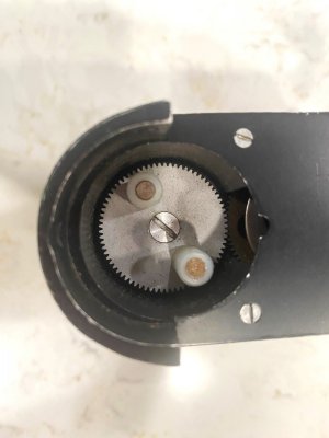

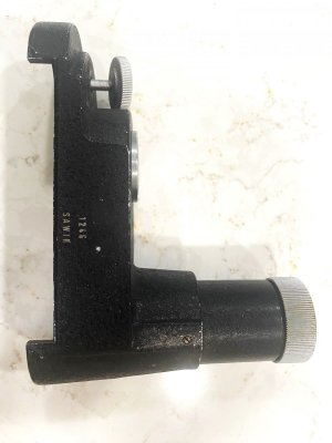

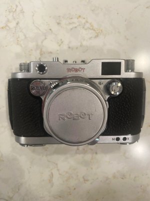

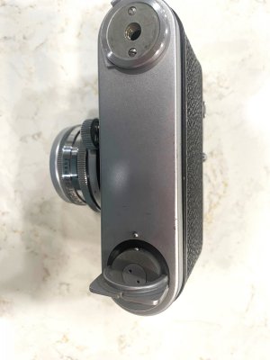

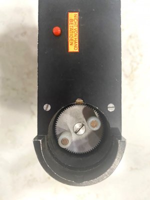

I have recently purchased the SAWIR spring motor for my Robot Royal 36. It is really cool but getting it to work has been a problem. The spring mechanism winds and is strong but when mounted to the bottom of the camera, nothing happens. Obviously it is not making contact with whatever is needed to advance the shutter to the next frame. Without any documentation or manual to suggest how to couple this, I am assuming the winding handle on the camera must have to engage the gearing of the SAWIR as I don't find any other contact points to make it work. I am usually very good in figuring out these puzzles with older cameras, but this one has me stumped. Any Robot users out there who may have these or anyone with any manual or advice on how to couple these two? It seems Robot information is hard to come by, other than mid to late 60's price lists, with either very few users or those knowledgeable about the cameras. I have the lenses, accessories, case, manual, (doesn't mention SAWIR) for this Robot and have for about 15 yrs. It is one of my favorite collectibles and just to hold one is an experience. Nothing like a solid piece of metal which is marvelously engineered and works like a charm, other than this experience.
Any help would be appreciated or if you know of a Robot collector or user, I would appreciate the contact. I love these early motor drive cameras and reminds me of my Praktina with spring motor, my Auto Terras, and the cool little Ricoh Auto Shot.
Thanks for looking,
Gary

I have 35/2.8 Xenogon, 50/2 Carl Zeiss Sonnar, 75/3.8 Tele-Xenar, and the 30/3.5 Xenogon, which is really made for the Royal 24, but I have used on this 24x36 format, which does vignette quite a bit. I have collected this assortment over the last 15 yrs and have used sparingly, but it is one of my favorite RF cameras, I think just because of it’s sheer quality of manufacturing. I felt the same way when I first held an M3 in my hands for the first time. I thought, “Now I get why this camera is so well regarded”.
Wish you could try mounting the Sawir on your camera and see if you can figure out how it should operate?
