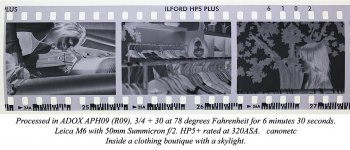

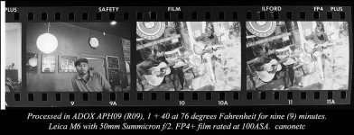

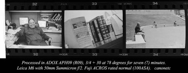

Hi All,
I recently purchased some ADOX APH09, which is a replacement for AGFA Rodinal.
I ordered the ADOX from J and C Photo’s website (where it is listed as R09).
I tested the ADOX on ILFORD FP4+ (125ASA), ILFORD HP5+ (400ASA) and FUJI ACROS (100ASA). Due to some warmth here in California, my water temperature was 76 to 78 degrees Fahrenheit. On average, this cut the normal development time by about four (4) minutes.
For example: With one (1) ounce of ADOX plus forty (40) ounces of water (at a temperature of 68 degrees F [20 Celcius]), the normal development time for Ilford FP4+ should be 13 to 14 minutes. With the water temp at 76 F, however, I cut this time to 9 minutes (but 10 minutes might have been better).
Ilford HP5+ was great. To save developer, I processed it with a mixture of three-quarters (¾) ounce of ADOX plus thirty (30) ounces of water at 78 degrees (26 deg. Celcius). A good development time was 6 minutes and 30 seconds, and it gave good results.
For FUJI ACROS 100ASA, I used three-quarters (¾) of an ounce ADOX plus thirty (30) ounces of Water at 78 degrees Fahrenheit, and developed for seven (7) minutes.
Attached are scans of the negs.
The bottle says to start a mixture of one (1) ounce of developer plus forty (40) ounces of water. For a single tank that can hold two reels of 35mm film, I find this is wasteful, because the bottle also says that the mixture is one-use only. So, to save developer and water, below is my breakdown for using less developer and less water, for the same development results:
R09 (in ounces) plus Water (in ounces)
1 + 40
¾ + 30
½ + 20
¼ + 10
All in all, the ADOX APH09 (called R09 on the J&C website) is a FINE replacement for AGFA’s Rodinol. I recommend it to all fellow Rodinal fanatics.

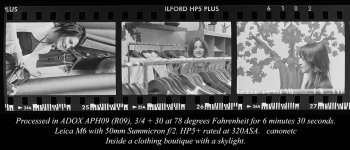

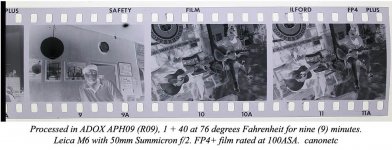

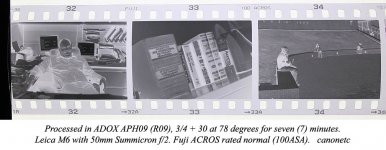

And for those curious, attached are the inverts of the negs...Cheers!
