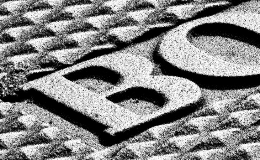

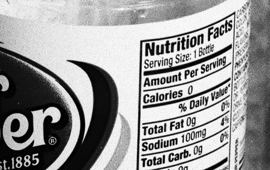

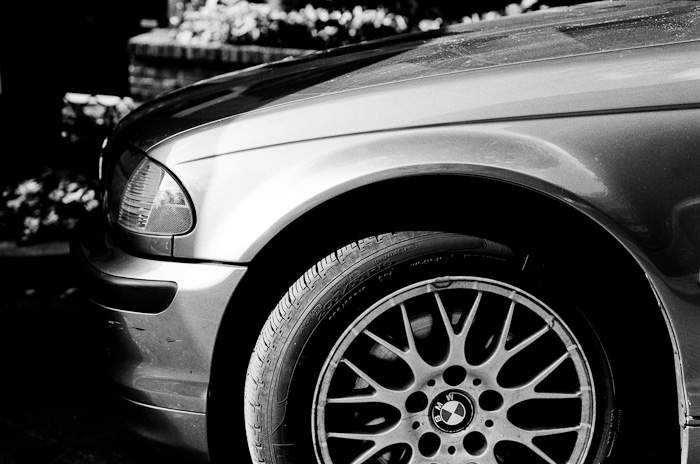

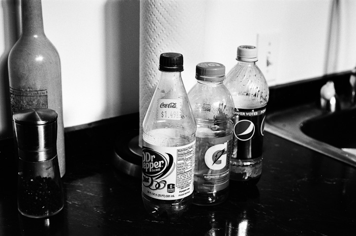

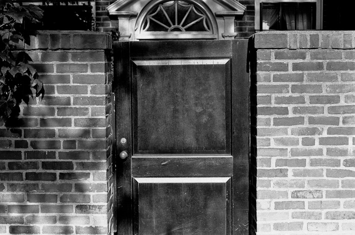

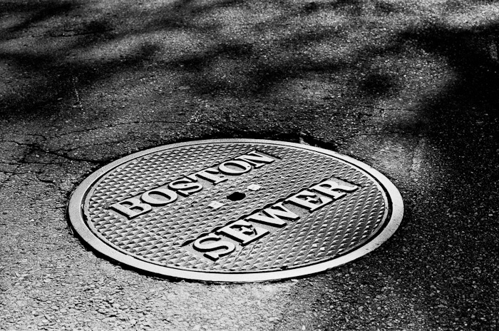

Some Samples -- Rodinal Stand Development
For what it's worth, here are some samples for this stand process. Shot on different film vs. my original post. Here are the specifics:
The processing is:
35mm LegacyPro 100 shot at box speed.
4ml Rodinal in 400 ml water. 70 degrees.
Initial agitation for 30 secs.
One more agitation at 10 minutes.
Let stand for to a total of 60 minutes.
The negatives are quite dense. The light was full sunlight/shadow and the scans from Precision are pretty contrasty, as you would expect. I like the gritty feel of these, but this is obviously getting pretty stylized.
This looks to me to be at least N+1 development. I might use this at 2x box speed to increase contrast or as a two stop push.
And, FWIW, here are two 100% crops from the Precision scans.
I should have mentioned that I worked all these a bit in Lightroom, basic adjustments.
