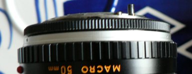

I am unable to mount the lens on the Pellix for apertures greater than 5.6. This is something I want to figure out. Is it the Pellix?

Can you shoot some pictures of the mounting surface of the lens?

I will do this tomorrow. The mount ring is rather thin.

Looks to me as though it may be an MC lens with an FD adapter on it ?

There is no adapter on the lens. The lens mount has been changed to FD (or FL?).

Looks to be just one lever inside the mount (aperture stop down) so this is a FL, not FD, mount. Most curious as to why anybody would modify this lens to fit a Canon SLR.

This is the second version MC lens by Minolt with the 58mm filter.

Not exactly. You can still see the Minolta lens flange; it has not been removed as part of the conversion. It appears that a Canon breechlock mount has been grafted onto the existing Minolta flange.
There doesn't appear to have been any attempt to alter the Minolta mount's diaphram lever. Does the diaphram lever move as you change f/stops? If it does it could be the reason for the mounting difficulties at certain f/stops.

I need to check this out, but it is most likely the incompatibility of Minolta with Canon levers.

it looks like an homemade adaptation, it has no protection around the back lens and cam
It looks more like an FL mount than an FD mount, so it probably needs to be shot in stop-down mode (does the pellix have that? I don't have one).
The FD lenses have a little stub which presses a button in the camera; how far the button gets pressed in tells the camera the maximum aperture of the lens. The FL lenses don't have this stub, so they just register as 5.6.

Yes, this is an FL mount. The 5.6 aperture is as much as the aperture lever can be turned when mounting the lens.

The Pellix, like its contemporary the FT, is an FL-class camera. It doesn't support full aperture metering with FD lenses.

oohhhhhh... So this is an FL mount lens, on an FL camera?
