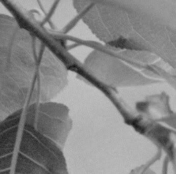

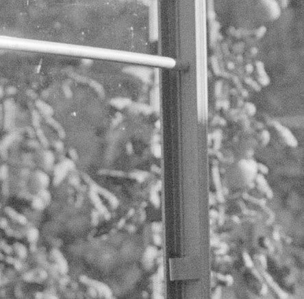

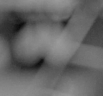

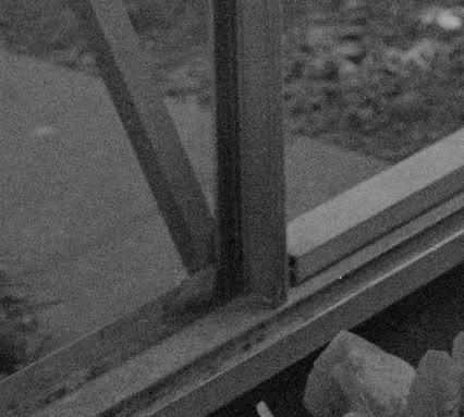

I have some crops here, 1600dpi, no USM, histogram with black and white points, no clipping. Delta 100 in Diafine vs. Rollei R3 in Diafine. The Delta has more bokeh (where grain looks worse) and delta EI was 80 vs 50 for the Rollei. Imho the delta is clearly superior (and I don't think Diafine is a great dev for delta100).
delta 100, sharp leaves in a sea of bokeh
delta 100, lots of bokeh
Rollei R3, shadow area
Rollei R3, highlight area
anyway,whatever the grain issue, the iso 50-100 speed is rather disappointing, so I'm not going to try Diafine again. The film seems to be a strange beast, I've read about sub-optimal results in D76 and Xtol. It should be good in the recommended developers though(Rollei HighSpeed & LowSpeed, =AM74 & =CG512). I have a bottle of AM74, when I've tried that combination, I'll let you know.
