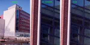

Hi, I am really having difficulties in scanning Fuji Superia Reala with my Nikon V-ED.
Scanning without ICE gives me a lot of these strange orange/pink spots.
it does not look like grain, it looks more like some kind of noise, but with ICE switched on they disappear, so i suggest it can't be noise.
please see attached examples (4000dpi scan from Silverfast).
is there any solution to avoid this?
thanks,
d.

the second one is from a year ago and from a different processor/lab, but both are fuji reala. and this is not the first time i discovered this strange noise, i'm just not always scanning with such a high resolution and ICE switched off. so i think any processing-related problems can be excluded.

would you be so kind and post an example.
scanned without ICE would be great. just to compare.
normally i am not the pixel-peeping guy, i just want to find out what's going wrong here because ICE is not always an option (especially for large landscape-prints with its very fine details).
that is definetely very interesting and thank you very much for raising this issie!!!
This might the the real reason why scanning film produces much noise than expected for any film too, those bubles are really interesting, I have access to electron microscopes and I will try to investigate by my self :) and keep you informed if I find something...

Yes, I didn't scan this image with Ice. The image was scanned with nikonscan with defaults, except I disabled sharpening.
From looking at your scans, I suspect the emulsion has some crap embedded in it. I have some provia scans here somewhere that show black speckling. I didn't notice it from looking at the slides on a light table, but examining them very closely I can see the garbage. Dirty chemistry is no doubt the cause.
