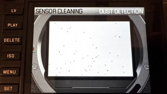

Case studies.
M246 first - these are photos of the dust detection function, I don’t think you can save the images which would be a lot easier than taking a pic of the back screen.
M246 before:

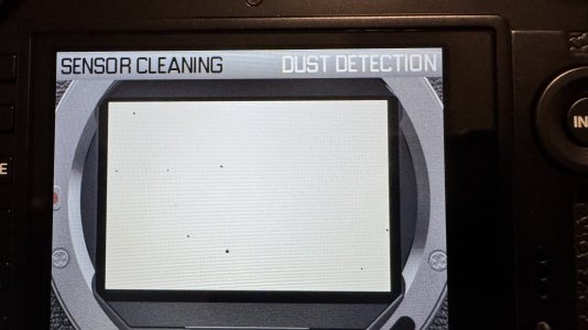

M246 after a stern rocket blowering:

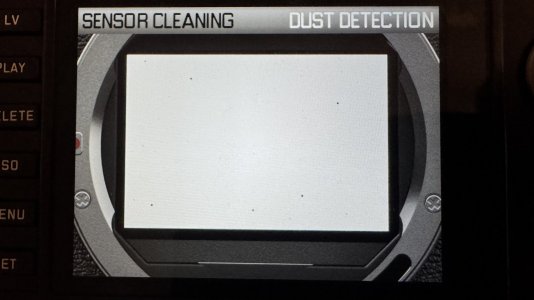

M246 after brush and wet clean:

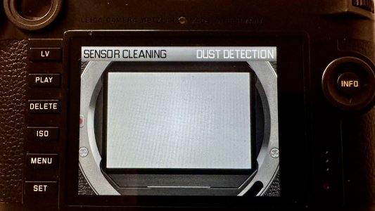

Now the M-P 240.
M-P 240 before:

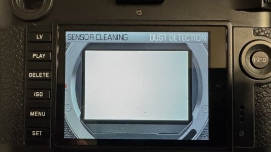

M-P 240 after rocket blower:

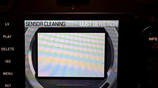

M-P 240 after brush and wet clean:
I have to decide what to do about the M-P 240, there are a few persistent spots. I’m thinking I want to try one of those generic Arctic Butterfly brushes and possibly the Pentax gel stick, if push comes to shove I’ll take it in - but I'm open to suggestions.

For anything stubborn, the best start is to get a look at it. Buy or borrow a sensor magnifier and figure out if the dot is caused by an oily, adhering or confusing substance. Go from there.
Good idea - my 3x Optivisor and a flashlight ain’t cutting it. There’s a lit 7x on Amazon I’ll order.
