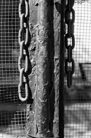

Nine months on Double-X using D23 and D96.
Some examples:
Double-X in D23:
Chain, in full early fall sun
Corrugated Metal Wall, in full afternoon sun

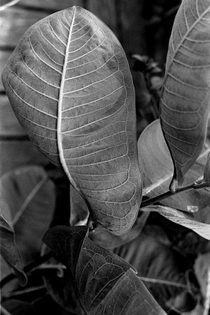

Double-X in D96:
Dog, indoor later afternoon reflected light 1/30,
Leaf and Cat in late afternoon winter cloudy day light.

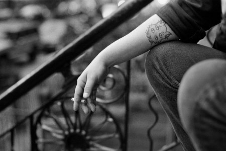

Arm, late afternoon Fall

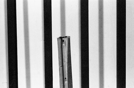

Fence, late afternoon sun winter

The tonality of the 'Arm, late afternoon Fall' is really appealing. What are your thoughts after comparing the two developers? I can't see a lot to choose between them based on this selection of (very nice) images, but maybe you can? D-96 is a more complex formula - is it worth the extra effort, would you say?Nine months on Double-X using D23 and D96.

It's a tough call. The ease of D23 keeps me using it, but D96 has nicer tonality I think. I'll have to review the last 6 months, which have been all D23 and XX, with this question in mind.The tonality of the 'Arm, late afternoon Fall' is really appealing. What are your thoughts after comparing the two developers? I can't see a lot to choose between them based on this selection of (very nice) images, but maybe you can? D-96 is a more complex formula - is it worth the extra effort, would you say?
