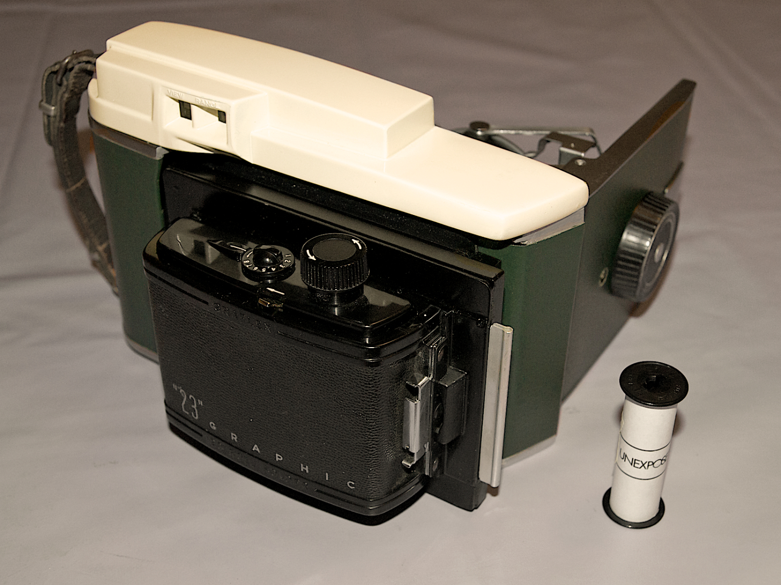

My 110A/600SE conversion. CB103 back, and hacked Graflex 6x9 on 600SE type back/adapter.
http://on-your-kitchen-worktop.blogspot.no/2012/06/polaroid-pathfinder-110a-brought-back.html
http://on-your-kitchen-worktop.blogspot.no/2012/08/lucy-hybrid-120-roll-film-adapter.html

Thanks for posting your build Ezzie! Your 110 has classic good looks, especially like the cream and green combo.
