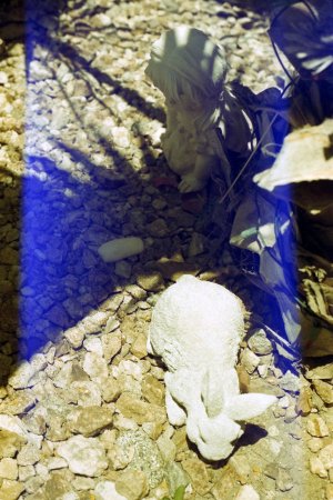

Most likely you will see two parallel light leaks on the top and bottom of your film. This has happened to me before. Dont take my word on this but I suspect that the two black velvet strips that lays behind the shutter ribbons are what allows for stray light to get through. Its likely much worse now given how old the velvet material is. I remember reading somewhere that Nikon was figuring out the best way to improve light baffels in their cameras well into the 1970s so i guess it was a ongoing issue in their rangefinder days.

Only one frame. I never had repeated frames when that type of light leak happens to me. And honestly, that light leak happened when I was charging a lens and the camera, without a lens, was pointed up getting direct afternoon sunlight. Just like what the other comment says, Dont get paranoid about it.
