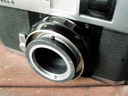

This is what I'm going to mount the lens to:
Now I need to figure out the aperture. That opening is 27.66mm and with the lens taped in place, I got the meter of the R to read "correct" exposure as 1/1000 for ISO100. With my J-3 lens, to get a similar reading, I needed to set the lens to f1.5 . To get to somewhere around f11 I am going to place a disk with a small hole in it between the lens and the mount. Trial and error will suffice for this but I think I'll start with 4 or 5mm and see what shutter speed that gives me.
Run a short roll of film through this before I permanently attach any of it and see how things look. Adjust as needed, then epoxy it all together.
