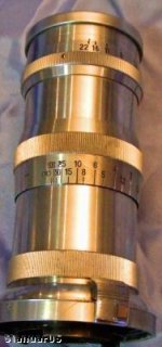

today I got a 135mm 4 Sonnar for my IIa on ebay. it went for 31 € so the price is more than just ok. my question is, do you think that it's a real Zeiss Jena Sonnar? I don't really mind cause a J11 would be fine too but a Sonnar is a Sonnar. any advice is welcome

There are points to look at like large "M" rather than small "m" on the distance scale, large screw heads, purple coating etc. Yours looks like an un-coated pre-war 135mm Sonnar in heavy chrome mount. If so it would not be a J-11 as they are coated (usually deep purple) and in light aluminum mounts (the post-war Jena and CZO lenses are also in aluminum mounts). BTW the pre-war 135mm Sonnar lenses are great performers.

Hey Santino! Check if the scale indicator meters symbol is written in lowercase... German lenses used a lower case "m" while russian lenses bear an uppercase "M"... there's a 135/4 sonnar on ebay (ending in a few hours) you can look how is the depth of field scale on the body.

the "m" is written in lowercase as far as I can tell from the pictures.

It's probably genuine. Real Carl Zeiss Jena, & even the W. German Zeiss-Opton & Carl Zeiss, 135/4 Sonnars are pretty common & probably not worth counterfeiting.
