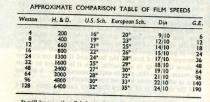

I think that was Scheiner, if I remember correctly. I've got an old film speed conversion table (pretty sure it was printed in 48) here somewhere. I will post again if I find it, but it's in a moving box somewhere...
To confuse matters even more, I think there was both American and European Scheiner, which were different.
Here we go.... Tables attached.

BS (British Scheiner), later renamed BSI (British Standards Institute), was a short-lived speed system based on the same mathematical principle as DIN - one table below also features the completely forgotten APEX, a first attempt at a global standard from 1962.
All the best, Ian
