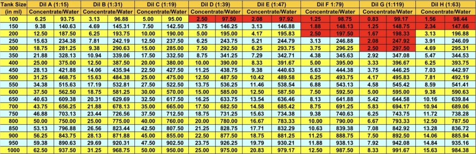

I made the attached table for HC-110 and different size tanks. Never had a problem, including using two baths at 1+50 and 1+200.

in the ilfotec manual dilution 1+31 requires 1 part stock to 7 parts water. or as they say for a full liter 125 ml of stock solution and 750 ml plain water.
you are not getting the same chemical bath.. mathemtically the 125 ml of stock equates to 32ml of concentrate, and the 1+31 dilution you would have me use would equal the same 32 ml of concentrate, but what you are overlooking is that
that is one of the few dilutions where the math actually give an identical amount of stock chemical. some would have you use far more, or far less then the stock method does.
