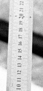

Michael,
I am just testing an M4 for focus after I had a few blurred shots.
This is what I do, since I don't have a calibrated apparatus to check it:
I put a ruler in front of the camera, at 45 degrees, and draw a small point on it. I place the target (the point) at about .9 or 1m. Then I focus on the point, and shoot the lens at full aperture.
Now, in theory, you should clearly see on the image where is the range in focus, and if everything is ok, the dot should be reasonably inside the field.
The thing is the RF focusing method, as precise as it is, still have its limitations (and don't forget our eyes) so I repeat the test several time, each time focusing from a different direction (from the far distance to the close, and vice versa). If I test a camera, I'll do this with several lenses, if possible, lenses that are known to be good.
With a 35mm f/1.2, you have no room for error, and the smallest distance discrepancy throws your focus off.

Sure,
and this is what I see on my front focusing M4...:bang:
Focusing a 35/1.2 wide open shouldn't be that critical, really. At 0.70 cm to 200 cm or so (I didn't check for further distances), you get about the same amount of DOF as a 50mm f2.5 - f2.8 lens shot wide open.
I'm not sure what's wrong with Michael's 35/1.2 and M2 combo, but a new pressure plate shouldn't change anything. Did anything else get adjusted while the camera was in for the new pressure plate, Michael?
Ray
About the direction of focusing: I'm testing the gear for that: I repeat the experiment alternating the directions.
any consistent problem in one direction or an other would mean either a slack in the lens mechanics or in the camera RF mechanism (or something impeding the movement in one direction)
