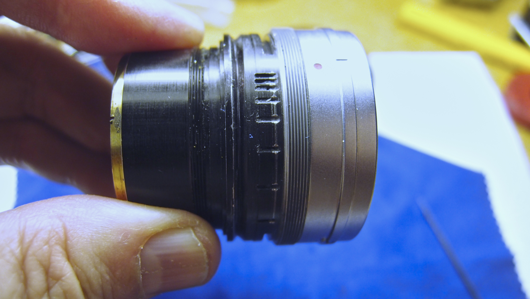

I'm surprised by how little information is available on taking this lens apart. I am doing a "hacking Project", and have been supplied a Summarit-M for the experiment. I need to remove the Optics Module from the Focus Mount. It seems like it should "just unscrew", but I'm not willing to force it as there might be a hidden trick. Just removing the three set screws below the aperture ring allow the whole module to rotate, allowing indexing of the F-Stop ring.
The front group DID unscrew, and at least I cleaned the heavy haze out of it.
I would appreciate some help and Tips on this-

Hi Brian,
I don't know if you saw this, but I left you a post in this thread: clean a summilux
I inserted a pin in a hole covered by a side screw until it engaged. Then I could twist them apart.
Let me know if you have any trouble,

Hi Brain,
After removing the three ring screws you'll be able to rotate the optics mount freely. Then, insert a pin in the hole and rotate the optics mount until the pin enters the hole in the focus mount ring. In the second photo you can see the whole in the focus mount ring that you'll need to engage.

Well Ricko, this one did quite well after I finished with it.
It did not work out for a conversion for a Carl Zeiss Opton Sonnar. It can be used for a pre-war Sonnar conversion. Now a Pro machine shop might have been able to bore out the parts of the barrel that got in the way. I did not go that far.
As it was, I opened up the glass, cleaned out the haze, tested it, and sent it to its owner overseas.
I'm not a Pro camera repairman. I'm a Pro FORTRAN programmer. But I did have several optical engineers that worked for me.
This Summarit after cleaning the haze out of the surfaces on each side of the Aperture mechanism.
Not bad for a $200 Leitz lens. The front element had a lot of cleaning marks. But the internal haze was the real killer.

Hi Brain,
