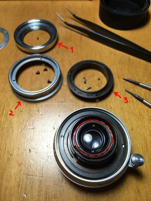

So I have tryed both front and rear sides of the lens, but failed. The first element in the front was easy. But I'm having troubles with the second group (picture below). Is it held in place just by pressure? It does not want to come out.
From behind, also no luck. There are three rings (like in the picture below), none of them wants to unscrew. As I'm not sure wich one is first, I'm not aplying too much force. I don't want to damage anything.

To remove the entire optical assembly (on the LTM version) you would unscrew the middle of your 3 retaining rings in the rear and then unscrew the entire front silver assembly. Then it comes out the front. But I don't know if the front piece unscrews on your version.

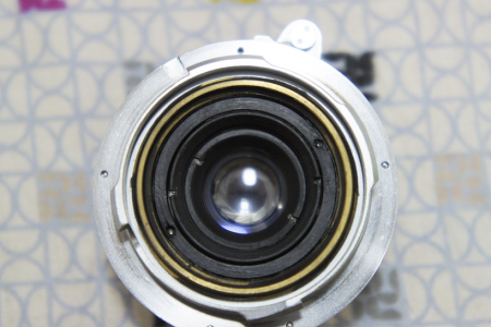

Thank you Bursby. Ok, knowing how it is held, I can think thee way to act. Looking at the video posted by @yossi It looks that the part that has to come out is the lens plus the circular black plate.:
Just to be sure, you mean No2 right?:
Yes, it's the same way on my LTM version. The glass lens with its surrounding black plate are all one single part that comes out together exactly as shown above.
Yes ring #2 needs to be removed on my LTM to release the optical block. But I think on your version you may have to take off #1 first. Maybe #2 as well. That should let you get the center core containing the optics out the front.
Ring #3 is removed when you want to separate the rear lens shown in the above photo from the rest of the optical block.

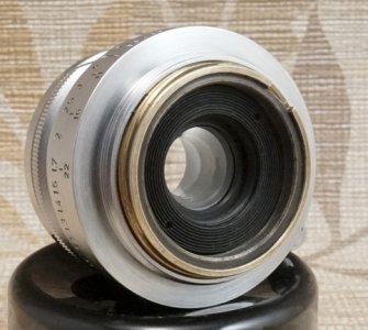

I could work a bit more in this. Still unsuccessful....:
1. I removed the tiny grub screw under the name plate. Unscrewed the front silver ring.
2. Removed the three screws to lift the aperture index ring.
3. The same with the two pins that holds the ring that operate the aperture. Careful with the two ball bearings.
And that's it. When I try to unscrew the rear retaining ring (wich requieres a lot of strength), the whole optical block rotate (dashed line). I'm stuck here.

You have to hold the front of the lens tightly to prevent it from rotating while turning the rear retaining ring with a spanner. It may take quite a bit of force. If you are not able to hold it with your hand, put a piece of sticky rubber on a table top and press the front mount into it to keep it from rotating.
This is ring #2 that we discussed in your previous post. It is the key to removing the optical block.
I would have tried to remove the rear retaining ring first, before removing all the front assembly because now you have less to hold onto to immobilize the front.
