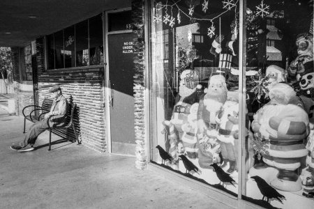

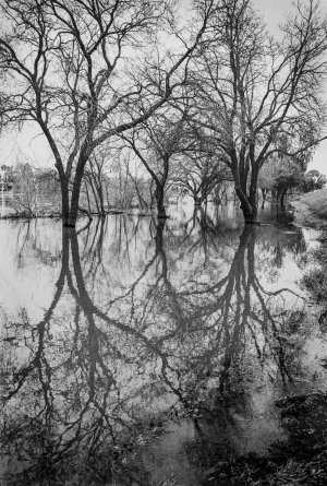

This is HP5+ exposed for ISO 400 but developed based on the Massive Dev Chart recipe for ISO 800 in Rodinal 1/25 dilution. This is my usual thing - develop for one stop faster than the exposed speed to get some shadow detail.

Hard to tell from just a couple of pictures but I’d expect overdevelopment to increase the contrast and, probably, increase highlight density significantly without giving much more shadow detail. The ‘pushed look’ is usually more contrasty with blocked shadows, but with normal exposure the shadows will be fine alongside the increased contrast.
