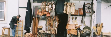

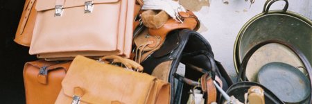

This is the guy Ash needs:
I can see him right now from my window as I type.
