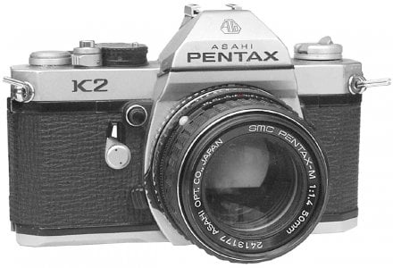

Pentax K2
The top-or-the-line model in the original Pentax K line of 1975, the Pentax K2 replaced the Pentax ES II screw mount autoexposure camera, and was the first Pentax to feature a vertical run metal focal plane shutter capable of a higher X-sync speeds (1-1/125 sec) than the horizontal running cloth shutters in the simultaneously released Pentax KM and KX. The K2 featured aperture priority autoexposure, as well as match needle manual metering like the KX, but unlike the KX the set aperture was not visible in the finder. The Pentax KM was basically a K-mount version of the Pentax Spotmatic F, with center-the-needle, open-aperture metering—a very nice camera indeed.
Top of the line Pentax K2, successor to the M42 mount ES II, was the flagship of the first group of K-mount Pentaxes released in 1975.
Both these linkages are arranged so that they are aligned and spring-loaded by the air of inserting the lens and turning it until it locks in place. Bodies equipped with the original K-mount include all members of the K series, the M series (except the ME F) and the LX. Lenses that support it include those labelled 'SMC Pentax', 'SMC Pentax-M', and 'SMC Pentax-A'. These K-mount bodies cannot use lenses that lack an aperture ring, such as FAJ or DA lenses. K-mount lenses can be used on all Pentax bodies, but are restricted to stopped down metering mode when used with KAF-mount bodies.

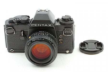

The Pentax LX: The best of the manual focus Pentaxes?
The Pentax LX was the most advanced manual focus Pentax. Launched in 1980 to celebrate the 60th anniversary of Asahi Optical Co. (thus the LX, 60 in Roman numerals), it was Asahi Pentax's contender for the professional segment of the 35mm SLR camera market, competing with such stalwarts as the Nikon F3 and Canon New F-1. Introduced in 1980, when the M-series models were still in production and in production until 1997, it’s slightly larger than the Pentax M cameras, but not as large the Pentax K2 DMD it replaced as the flagship Pentax. It’s well sealed against moisture and dust, has more interchangeable viewfinders and focusing screens than its rivals (including a super-bright S69 screen).
The Pentax LX employs an advanced in-body TTL OTF metering system that can read the light reflected off the film and first shutter curtain during the exposure (based on a Minolta patent that was used in the Olympus OM-2), and it displays the selected aperture and shutter speed in the finder. It provides aperture priority autoexposure and metered manual exposure, but neither programmed autoexposure (P mode, which first appeared on the Pentax Super-A), nor autofocus (AF). The LX has a horizontal travel titanium focal plane shutter with mechanical speeds of 1/75 sec to 1/2000 sec, manual settings from 1/2000 sec to 4-sec, and electronically controlled speeds of 1/60 sec to 125 sec, and has been widely praised for its reliability. The Pentax LX has a very sensitive SPD metering system (EV-6.5 to EV 20 at ISO 100), accepts a Winder LX and a 5 fps Motor Drive LX.
Pentax LX in black with 50mm f:1.4 SMCF Pentax-A lens.jpg
Pentax LX with 50mm f/1.4 SMC Pentax-A lens. Widely hailed as the best manual focus Pentax ever its coveted by both users and collectors.
Note: During its long 17-year production run the Pentax LX was updated at least three times. The latest revision has three visible differences compared to the earliest models: there are two white points missing on the front of the first shutter curtain; pressing the button that releases the viewfinder causes the light meter to turn on, and the shutter-lock switch features a new design. Several attempts to determine which serial numbers coincide with these design variations have so far proven inconclusive.

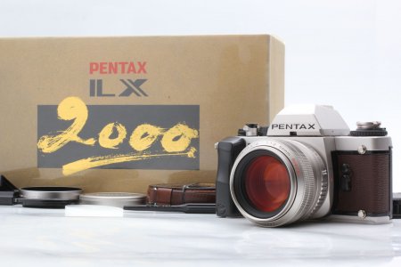

The Millennium Model Y2K/2000 Special Edition LX: Surprise, surprise--this special-edition Pentax LX was produced in the year 2000. Like the LX Gold it came with a 50 mm f/1.2 Takumar lens, but this time in a special brushed aluminum finish.
Rare Unused in Box Pentax ILX 2000 with 50mm f:1.2 Special Lens.jpg
Rare Unused in Box Millennium Pentax ILX 2000 with 50mm f/1.2 Special Lens in a special brushed aluminum finish. Gorgeous, but expensive!
You can snag a “Rare Unused in Box Pentax LX Titan 75th 1000 Limited” model with no lens for $2,499.99 plus $40 shipping from Japan, a “Rare Unused in Box LX 2000 with 50mm f/1.2 Special Lens” for $3,499.99 plus $80 shipping, or a “Pentax LX Limited Edition 18kt Gold with matching 50mm f/1.2 SMC Pentax lens (number 36 of 300 made) for $3,943.10 plus a piddling $8.40 shipping from the U.S. All are currently listed on eBay, so take your pick!
