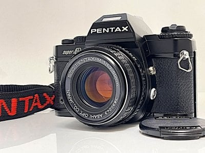

Pentax Super A (Super Program in N. America)
Introduced in 1983, the Pentax Super A/Super Program was accompanied by a new line of SMC Pentax-A in KA mount with an "A" lock on the aperture ring that allowed the body to set the f/stop for programmed and shutter priority AE modes. The camera can also be used in aperture priority AE and metered manual exposure and has two flash modes (TTL auto flash and a programmed mode for dedicated flash units). Lenses with earlier versions of the K-mount (K and KF) can also be used, but without shutter-priority or programmed AE modes.
Pentax Super A with 50mm f:1.7 SMC Pentax-M lens.jpg
Pentax Super A with 50mm f/1.7 SMC Pentax-M lens. Translucent panel on pentaprism that illuminates finder readouts without battery power.
Exposure modes are selected using a dial concentric with the shutter release, along with the aperture setting of the lens. The shutter dial has the following positions:
L (locked)
AUTO
M (manual shutter-speed selection)
125 (shutter speed fixed at 1/125 sec for flash sync)
B ('B' shutter setting)
In the Auto position, setting the aperture to 'A' on the lens gives programmed AE; any other aperture value gives aperture-priority AE. In the 'M' position on the dial, setting the aperture to 'A' gives shutter-priority AE; any other value gives metered manual exposure. Shutter-priority AE works normally if the shutter speed is set to 1/125 sec.
The Super A offers a wide shutter speed range of 15 to 1/2000 sec. Shutter speeds are selected electronically via rocker buttons on the top panel, a method used the Pentax ME Super. The selected speed is displayed in an LCD panel next to the release, and simultaneously in the viewfinder. Another LCD in the viewfinder shows the aperture value when in programmed or shutter-priority AE, but not in aperture-priority AE. In metered manual mode, the second viewfinder LCD shows the number of stops over- or under-exposure in up to +/-3EV values based on center-weighted average readings.
The camera is compatible with Pentax dedicated flashes, and there’s an in-finder flash-charging indicator. With dedicated flashes that support TTL metering, the camera automatically sets the proper lens aperture, when in programmed or shutter-priority AE, and the flash indicator in the viewfinder flickers after exposure, to verify correct exposure.
The viewfinder has a central split-prism rangefinder surrounded by a microprism collar, and the camera accepts an external winder (once finger-grip on the front of the body is removed). There’s a self-timer to the right of the lens mount and a PC contact on the left. The camera requires two 1.5V LR44 alkaline or SR44 silver-oxide batteries, or an equivalent 3V lithium battery. The viewfinder LCDs alternate correct settings data and an 'ooo' readout when the batteries are low.
Note: The Super A was followed in 1984 to 1988 by the similar Pentax Program A/Program Plus— a less expensive model, that lacks the Super A's top LCD and 1/2000 sec shutter speed and offers programmed AE but not shutter priority AE.
While neither the Pentax Super A/super Program or the Pentax Program A/Program Plus has the visceral panache of a Pentax LX or even an MX, these models are clearly among the best buys out there for anyone hankering to get into analog photography on the cheap. They’re widely available complete with 50mm f/1.4 Pentax lens for $150 to $200 and you may be able to glom onto a nice one for even less. In terms if picture talking potential per dollar that’s awesome.

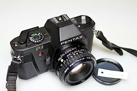

Pentax P30/P3 1985-1988: Known as the P3 in the U.S. and the P30 elsewhere, it was a broad-spectrum camera aimed at casual shooters as well as enthusiasts and it featured traditional shutter speed dial with a PROGRAM AE setting, It features a KA mount for P mode, provides Av mode when M or K series lenses are used, and works with any manual focus lens up to the FA series.
Pentax P3 (P30) with 50mm f:2 SMC Pentax-A lens.jpg
Pentax P3 (aka P30) with 50mm f/2 SMC Pentax-A lens. A broad-spectrum SLR with a traditional shutter speed dial and PROGRAM AE setting.
The pentaprism viewfinder covers 92% of the on-film image at 0.82x magnification and has a matte focusing screen with a horizontal split-image rangefinder. Its manual wind lever has a 130° throw, modes include Program, Manual X and B exposure modes, and it provides shutter speeds of 1 to 1/1000 sec (down to 8 sec in P mode), The X mode provides automation with some Pentax flashes, and there’s an exposure lock, but no exposure compensation. The meter provides center-weighted readings from EV1 to EV 18 (at ISO 100 with f/1.4 lens) and in-finder LEDs show the selected and recommended (blinking) speeds. DX coding ranges from ISO 25-1600, but there’s no manual film speed setting. Other features: 12-sec self-timer, DOF preview lever, power supplied by two 1.5v SR44 or LR44 button batteries. The U.S. P3 version is all black; international P30 versions are dark gray.

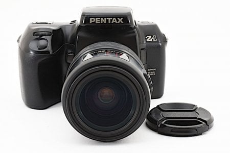

The flagship Pentax Z-1 of 1991 utilizes KAF2 lenses and is also compatible with earlier K-mount lenses. KAF lenses support most Z-1 features except those related to power zoom capability. KA lenses with apertures of f/2.8 or faster can be used, but only with the AF Adapter 1.7X; without the adapter lenses with apertures of f/5.6 or faster can be focused using the Focus Indicator (FI), and in Shutter Priority and Programmed AE modes. Manual aperture K-mount lenses can only be used in Aperture Priority AE and manual modes. A special edition Z-1 SE was issued in 1994 to commemorate the 75th Anniversary of Asahi Optical company, and the Z-1 was succeeded by the Z-1p in 1995.
Pentax Z-1 with superb SMC Pentax FA 28-105mm f/4-5.6 zoom. With robust build and a full feature set it was the flagship Pentax of 1991.

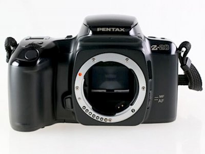

Pentax PZ-20/Z-20 in the U.S. 1992
The Pentax Z-20 is a broad-spectrum, mid-level autofocus 35mm SLR with a built-in retractable TTL auto flash that uses Pentax KAF2 -mount lenses and provides power zoom capabilities. It uses an electronically controlled vertical-run metal focal plane shutter with speeds from 30-1/2000 sec and has a 12-sec electronic self-timer. Exposure modes include picture modes (portrait, landscape, action, and closeup) Program, AV, Tv, and metered manual mode. The metering system covers a range of EV 1 to EV21 (at ISO 100 with 50mm f/1.4 lens, the ISO 35-5000 DX coding system is complemented with manual ISO settings of 6 to 6400, exposure compensation of +/- 3 stops is adjustable in ½ steps, the built in pop-up flash has a metric Guide Number of 13, the built in motor advances the film at up t 2 fps, and it’s powered by a 2CR5 lithium battery.
Pentax Z-20 body incorporated a TTL phase-matching SAFOX II AF system for enhanced AF performance, and 6-segment multi-metering.
The Pentax Z-20 employs a TTL phase-matching SAFOX II AF system, provides a focus lock, and enables 3-speed power zoom, Zoom Clip Mode, Image Size Tracking Mode, and Auto Zoom Effect when used with an FA zoom lens. The Penta-mirror finder uses an Aspheric Micro Matte focusing screen, covers a 92% field of view at 0.77x magnification, and provides lighted full-info readouts in the finder and via a full-info LCD panel. Other features: auto loading and auto rewind, TTL 6-segment multi-metering, a learning function in Hyper Program Shift, and a removable back cover. It measures 5.7 x 3.7 x 2.5 inches (W x H x D) and weighs in at 17.6 ounces, body only without battery.
The Z-20 is an excellent all-around shooter, except perhaps in low light where its slightly dimmer penta-mirror viewfinder isn’t the hot ticket. The Pentax Z-20 is readily available used in clean working condition with Pentax prime or zoom lens at prices in the $50-125 range. You can occasionally snag one fir a lot less and truly mint examples may be somewhat higher priced.

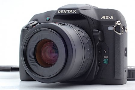

Pentax MZ-S (Flagship model)
The Pentax MZ-S was introduced in 2001 as the top-of-the-line Pentax SLR with a study body of magnesium alloy. It reintroduced analog dials and had a slanted top panel as a distinguishing feature. It has high speed flash synchronization at 1/180 sec and shutter speeds up to 1/6000 sec. The flash system works with the in-camera flash as well as with the AF360FGZ wireless TTL flash unit. The MZ-S also featured imprint of exposure information on the edge of the film.
Pentax MZ-S with Pentax SMC 35-80mm f4-5.6 zoom: This formidable full-featured model commands premium prices on the used market.
Program modes: Normal, Action, Depth of field and MTF (Modulation Transfer Function). In the MTF program the camera sets the aperture to the value where the lens performs the best under the given light (it only works with F and newer lenses which has the required information encoded in them). Pretty spiffy.
Here's one reviewer’s assessment of the virtues of the Pentax MZ-S:
The MZ-S gives you boatloads of capability if you want to tap into it. It has 19 programmable functions ranging from setting auto bracketing to using the internal flash as a trigger for an external flash.
Here’s my assessment of the key selling features of this camera:
  • Autofocus, using a six-point version of Pentax’s SAFOX AF technology.
  • Six-point metering with options for center-weighted, spot or multi-segment.
  • 1/180 flash sync.
  • 1/6000 maximum shutter speed (I’ve never needed it, but it seems cool to have).
  • DX coding with manual override.
  • Automated film advance/rewind at up to 2.5 frames per second (blisteringly fast for 2001, I suppose).
  • Depth of field preview.
  • Bright viewfinder with 92% view (you can even have the focusing screens changed out if you want).
  • Photo information data imprinting (outside the image area… you’ll likely need a loupe to read it though).
  • Film reminder window for the forgetful.
  • And of course, the venerable K mount with its access to a universe of lenses.
Highly valued and much appreciated by Pentaxians, the Pentax MZ-S commands a premium price on the used camera market. They’re readily available but they typically run about $300 to $350 in good nick at the leading online auction sites and perhaps even more for mint examples fitted with a desirable lens like the superb Pentax 28-70mm f/4 Zoom. This could well be a case of getting what you pay for.

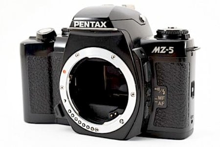

Pentax MZ-5 (ZX-5 in the U.S.)
Introduced in 1996 this enthusiast aimed autofocus 35mm SLR uses the Pentax KAF2 mount, which accommodates earlier K-mount lenses, and sports a traditional shutter speed dial. Its electronically controlled vertical metal-bladed shutter provides speeds of 30 to 1/2000 sec, its exposure system incorporates Av, M, P, and TV modes except that P and Tv modes are not available with M and pre-A type lenses lacking an “A” setting on the aperture ring. A, F, and FA lenses support 6-segment evaluative, center-weighted, and spot metering modes while K and M series lenses support center-weighted and spot. Other features: +/- 3EV exposure compensation in ½ EV steps, metal lens and tripod mounts.
Pentax MZ-5 (ZX-5 in the U.S.) offers multiple exposure modes, a retractable built-in flash, and a silicon photo diode (SPD) metering system.

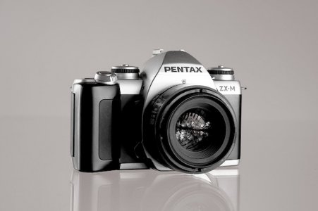

Pentax MZ-M (ZX-M in the U.S)
In 1997 Pentax took a big gamble in introducing a manual focus camera in the M-series mold, essentially as a niche filler for the eternal K1000 that was finally discontinued that year. Basically, it’s a manual focus version of the Pentax ZX-5, minus the autofocus, built-in flash, or TTL flash metering. Regrettably, they also replaced the metal KA2 lens mount with a less durable plastic one, but at least they retained the 2fps motorized film transport.
Pentax ZX-M with 50mm f:1.7 Pentax lens.jpg
Pentax ZX-M with 50mm f/1.7 Pentax lens. A nice manual focus Pentax except for its less durable plastic KA2 lens mount.
Pentax MZ-M/ZX-M Specifications
Year of launch: 1997
Manufacturer: Pentax
Type: 35mm manual focus SLR
Lens mount: Pentax KA2 (plastic)
Film type: standard 35mm cartridges with speeds of ISO 25 to 5000 with auto DX, and manually input from ISO 6 to 6400
Metering element: silicon photo diode (SPD)
Metering range: 0 to 21 EV
Focusing: manual.
Programs: Av, M, P and TV modes
Shutter: Vertical travel metal focal plane shutter with speeds from 30 to 1/2000 sec. B
Film advance: fully auto advance at 2 fps with auto rewind
Viewfinder: 0.8 magnification x 92% coverage, shutter and aperture LED display.
Power: 2x 3v CR2 lithium battery or Battery P ack FG
Dimensions: 135 × 90.5 × 55mm (W x H x D)
Weight: 320g, body only.
The Pentax ZX-M or MZ-M is currently available for a piddling $35 to $50 in clean working condition complete with Pentax prime lens. It would have been a creditable replacement for the iconic Pentax K1000 were it not for that plastic lens mount, and it might still suffice as a K-mount backup camera or as your kid’s first analog camera.

I have a Super A that sits alongside the MXs. An excellent camera with a great viewfinder. The push button shutter speed adjustment isn’t a problem as I mostly use aperture priority. I can ecen use the modern 40/2.8 DA lens in shutter priority or program in this camera. The P50/P5 also has a fabulous finder and is underrated.

An extract from a relatively recent post on Pentaxforums:
“The dreaded day has arrived and my Pentax MZ-5 is now suffering from the infamous mirror return problem. It started with a slightly longer reset after an exposure and quickly progressed to the mirror not resetting every third ot fourth frame. It occasionally stays up and will only release when the camera is switched off. I understand this is caused by a plastic cog splitting on the mirror drive motor, the repair of which is way beyond my capabilities so it looks as though it will end up on the well know auction sitte for sale as 'Nor Working - for Spares or Repair'.
I have owned several MZ models, all of which suffered a similar fate. They are repairable with a new brass cog but it is beyond my capabilities and not really economically viable. I believe the MZ-S, MZ3 and possibly MZ6 have better mechanicals.
Loved the MZ5n when I had one and it was working - I could use the DA40, which made a very compact kit.
I got a ZX-M for cheap some years ago and it's a decent little camera.
The P3 -- my mother had one in her later years of travel and it did the job well for her. My regret (and I was not in a position to do anything about it) was that she traded her very complete, well-used Leica IIIa setup for it, a high school graduation gift (!). Too bad I couldn't have just bought her the Pentax in return for her giving me the Leica gear (which included a Summar, many filters, and Rapid Winder).
I've had a few as well, with the MZ7 being my favorite
The dreaded plastic gear death is closer every day :(
Also the P30 suffers from the same weakeness as the ME (mirror box strut)
Besides the problematic plastic part MZ/ZX series cameras incorporate a frightening number of internal moving parts made of plastic.
Pentax repair specialist Eric Hendrickson refers to these as "Plastic Pentaxes"; they were the first Pentax SLR models he stopped servicing.
The Achilles Heel as mentioned is a plastic part; once it breaks camera body no longer functions.
Pentax once supplied an upgraded replacement made of brass. Alas this part is no longer made.
Later production may incorporate the upgraded part, however only disassembly can confirm this.
MZ-S bodies labeled PENTAX Corporation are a better bet than those labeled ASAHI OPT. CO., LTD.
