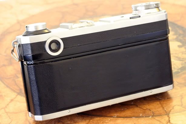

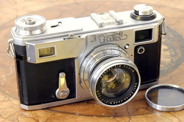

I wanted to share my new favorite camera.
This was constructed from many different kiev models.
The main body and shutter are from 1963 this one had a smooth running shutter.
The top housing and prism is from a 1981 model, now I have a hotshoe (after some internal soldering) and much brighter viewfinder.
Some modifications was required to attached an original shutter dail to this top plate.
Name plate and back door is from a 50s model.
The rewind crank is metal / custom, from my parts box.
The Sonnar was found for $33 but i had to preform a full cleaning / cla overall I really like this setup.
Rangefinder has been calibrated and light leaks eliminated.
I'll post some test shots soon.

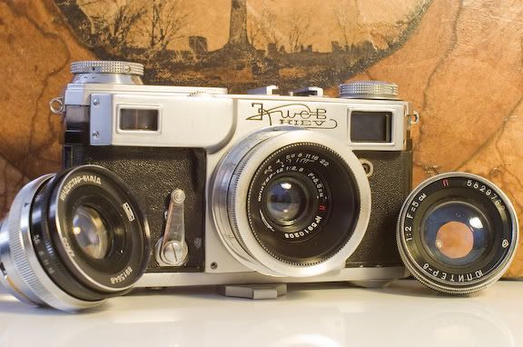

Also rebuilding an old Kiev III to a "flat top" nonmetered model.
And a INDUSTAR 61LD in Kiev Mount.

Great !!! It sounds easy the way you describe it, but I'm certain there is a lot of work there. What was the most difficult part of the job ??

To me everything is hard with a kiev, True test of patience in dealing with these cameras. But its worth every moment spent.
These are great cameras when tuned
Hardest step? Rangefinder calibration for sure.
Cleaning and resetting the shutter was also a challenge.

This looks great - much more than a "pimped" Kiev.
When I get the bits sorted, my Kiev will get fettled to my liking (minus sync and timer) but my Mrs threw away my spares bodies in a house move.
Can't wait to see the results from yours.

My next project is to make a Industar 61 in kiev mount!
The parts are waiting for me.

Great job! I do favour these kind of jobs very much.
Can't you remember to which camera your rewind crank originally belongs ? This issue is of highest importance. I have found some matching with the Olympus RD camera rewind crank and the Kiev AM/M, but this is a highly expensive camera (the Oly) to purchase for its rewind crank. A cheaper solution is required, and for the older kievs, whose mechanisms are better.
Another challenge maybe to pick up a Kiev with metered top and transform it into a non-meter flat head like this one. This, because there are much more non-working meter Kievs for sale than flat head Kievs.

Thank you very kind words.
I wish i knew where the rewind knob came from?
It was something something from my parts box.
Yes this camera was a metered version in the beginning.
The main issue with swapping parts with kievs is the machining "drift" meaning that screw holes dont always line up when swapping parts.
I had to adjust the screw holes for the topplate and other sections, dremel tool came in handy
