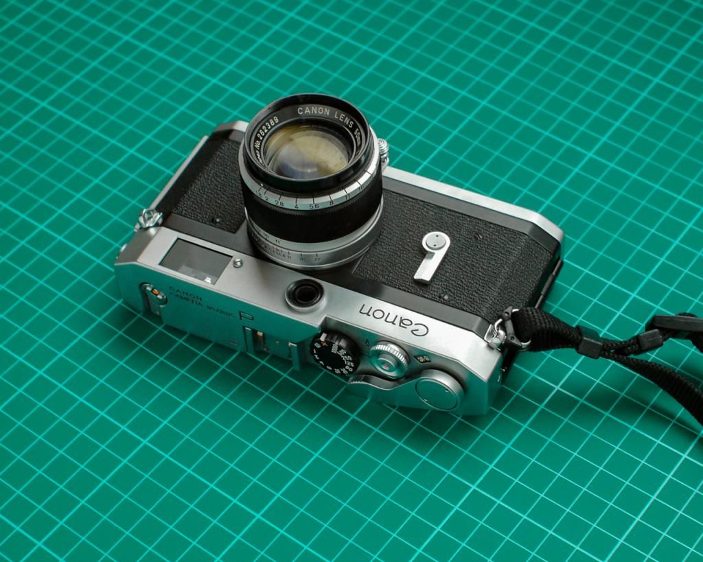

Canon P
Canon P
Hands down my favorite cameras. Of the large RF's the three I own all work perfectly. I did covet Raids "green P", but after all it's the insides that count. Two have minor wrinklies, one is pristine. All lenses that I use are LTM but that for me is not a limiting factor as there seems to be a LTM lens for most any taste. BY the way if you should find one with an unwrinkled curtain take care as most are wrinkled by the previous owners while changing film. So careful where you put yer fingers! Then enjoy. .. ...

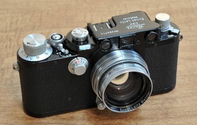

Canon P takes Leica NON collapsible lenses and its viewfinder is better than the Leica IIIf. Also, easier film loading (film for Leica needs to be specially trimmed) & handling. You can pair it with Canon lenses and as I stated Leica lenses; consider the 50mm Summitar, as an example.

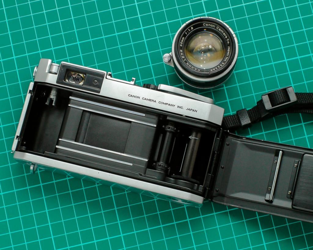

I can collapse a Summitar on mine. I think the VF is OK. The rangefinder is great, but the framelines are only OK. The only foam seals it needs are two little squares at the top and bottom of the back door hinge. Easy to replace with bits of velcro (loop side). One of mine is capping at 1/1000. I'll get that fixed eventually.
