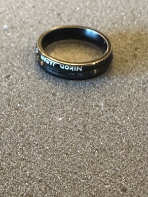

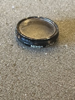

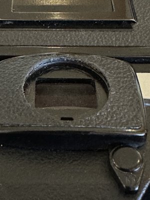

Here are pictures of the eyepiece. I do not see threads.

From more than 5000 miles straight away, I would say that:
the threaded ring on your viewfinder has been torn off
and that the threaded ring on the viewfinder is on your eye correction lens.
I've posted a few pictures for you to compare.
The eyepiece from the side, ya can - I hope so - clearly see the fine thread (M19 x 0,75 mm) on the outer side.

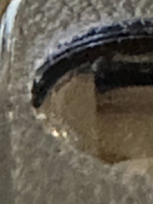

The thread in the ocular from the viewfinder
one can clearly see a metal thread.

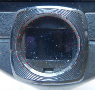

between the red dotted line is the metal threaded ring which should be normally in the viewfinder.
otherwise it has been brutally removed.

When the metal ring in the viewfinder is missing, then there is only plastic left.
You can cut that with a knife easily to test if it is a metal ring with a raped thread or if it is the plastic part where the metal ring is completely missing.
Sometimes some "Specialists" screw in a larger eyepiece from a F3 HP with force.
But a far as I can see on your pictures, the metal ring is missing, thats why the correction lens falls into it.
And it looks like the metal ring stucks on your eyepiece . . .
