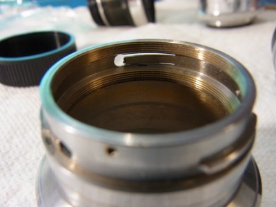

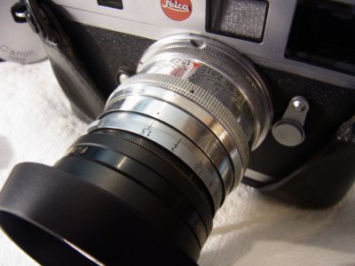

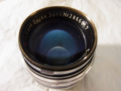

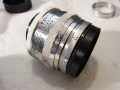

I wanted to compare a Transition lens with the Nikkor. I received a very nice Transition CZJ 5cm F1.5, very clean glass- in Contax mount. I also picked up a J-3 in LTM that needed a thorough cleaning and some polishing.
I used the retaining ring from a ZOMZ J-3, as this lens had none. I polished the retaining ring down about 0.05mm, then used a 0.01mm shim. F1.5 came up to the index, and focus is good through the range. Transition lens made in the 1940s, J-3 made in 1973. Somebody had a standard for starting positions for threads. This is one of the nicest that I've handled, glass is very clean.

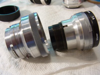

This transition Sonnar is one of the worst that I've ever seen, including 9 of 10 Valdai Jupiter-3s. I converted it to Leica mount, but did not disassemble the lens. After seeing the results, went ahead and took out the front element and middle triplet.
1) The middle triplet is loose in the barrel, the diameter of the fixture is slightly too big. Usually the middle triplet is a tight fit. The retaining ring would normally help center the group...
2) there was a burr on the side of the barrel that pushed the triplet off center.
SO- remove and clean the glass, get rid of the burr, put the glass back and "tap ever so slightly" on the side of the lens as I use the spanner to tighten it down. The theory being vibrations while tightening will help place the lens.

I have several v4 Carl Zeiss Jena 5cm F1.5 Sonnar "T" lenses, including one that had (past-tense as of this afternoon) a front element with more cleaning marks than I like. The Transition Sonnar has a near perfect front element. I suspect it's the Triplets that are the problem. SO- the question, are the front elements between the two lenses interchangeable? That would go towards answering the question if the Transition Lens has Zeiss glass. I popped the name-rings and the front elements: same diameter, fit perfectly. I swapped the two.
