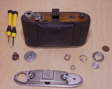

I dissassembled several Isolette IIs and there was a large hole on the opposite side of the film advance that I didnt know what it was for until I got a III and is the one to hold the RF unit.
