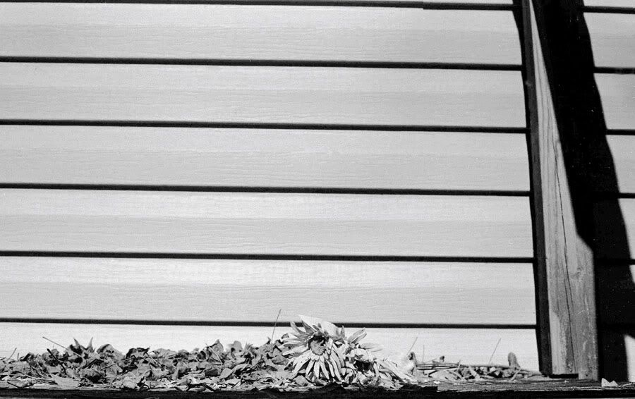

i have used tmax 1+4 and d-76 1+1. i'm trying tmax 1+9 now to see if i like it as much as the standard d-76 formula, because at 1+9 it is about the same cost as d-76 1+1 - and very easy to mix small amounts.
here are some tmax 1+9 samples, from epson 4490 negative scans:
seems to me the tmax holds highlight detail better, going just by scanned images ...
that makes sense. with higher dilutions we should see more compensating action. The shadows open up too. There's an increase in the tonal range. These look great. Thanks for posting your results. 🙂
i developed for 10 minutes, same as for d-76 1+1, at 68F/20C.
greg, i mixed up just a little more than i needed for one roll: 40ml of tmax plus 360 mls of distilled water.
so easy to pour and mix up what i need. i typically soup one or two rolls per week, so this is perfect for me from that standpoint.
keeping detail in highlights is what i was hoping for, for scans with my epson 4490. i reckon these negs will be easier to print, as well.
