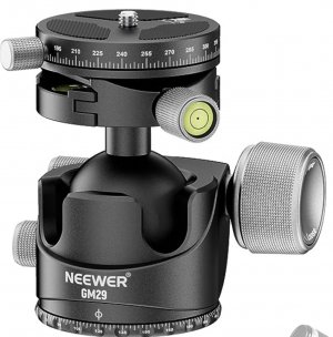

Two other options for getting level quicker. Either use a ball head to do it and then put a panning plate on top of that. That lets you use the ball head to get level and then pan easily from there. Something like this for example though I have an ARCA clamp on top, not the screw:

Shawn, I'm not really trying to avoid getting the legs level as such, but I would want to use the leveling base/head to make the final tiny adjustments which can be awkward to do by adjusting the legs. Once the leveling base/head is level, I would not be then be adjusting the aim of the camera with the leveling base/head, I would be using the tripod's pan and tilt head. I my have to crank the camera platform up a bit or pan the head left/right a bit, tilt it up or down a bit or flip the camera vertical from horizontal. IF the leveling base/head is level then movement of the tripod head would be starting from level as well.

Shawn, The Neewer GM29 set that you show doesn't really allow for easily tilting the camera up or down if necessary. I tried one of those "bowl-lead" things (not that brand though) but I couldn't get on with it.
