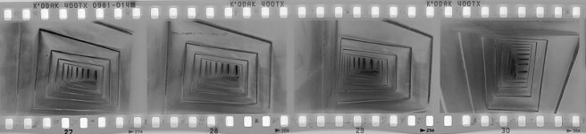

My first experience with Diafine. in 5 words - I failed, but not dispirited.
Every shot was exposed as told by my Besssa R (good meter, hope not mis leded)
Bulk loaded TriX good film.
4 min in A, then 4 min in B, stop with 22C water. 7 min fix time and 10 min rinse in 22C water. Results? Thin negative as you can see attached.
attachment.php
attachment.php

Why failed? Because the negative was thin. Scans ok and leveling works nice, so you can see the black in the tunnel (image up), but the contrast is missing. I like my negatives normal contrast.
Also, I don't want to show the bad frames with excessive grain (ashamed)
I'll step down to 1200 and may be 800.
Thanks

I suspect you may not like it at EI 800 either. I've gotten the best results at EI 1200, but I've also rated it at EI 1000 and it wasn't too bad. Any more exposure than that and it tends to block up - at least for me.
Thanks RF-Addict. Can you post the negative, not manipulated, scaned as document or positive?

Those negs do not look overly thin to me and the tonality looks good in your scans I think. Plus if you're scanning I generally feel you want a slightly thinner neg, much better than a bullet-proof contrasty one that the scanner will have trouble with. That said I usually shoot Tri-X at 1200 for Diafine too. Why did you bathe them for 4 minutes in each bath? I believe 3 min is the norm....
rich815 - Yes, they scan good and easy leveled in software, but perhaps hardly printable. I saw a video at YouTube as pointed by prev thread about Trix in Diafine here in RFF. The guy asked 10 min in dil A
