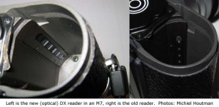

If you're looking, I'd opt for one with the newer DX reader- much easier in use than the original version- films will drop right out like with the other M's, the older DX contacts hold onto the film. My .72 will get to Solms one of these days for that upgrade.
spicoli
SR- How do I tell the difference? I know there is a difference in the M7 finders; some have the MP finder- some dont, but where the MP finder'd M7 serial number starts is documented. Is the DX upgrade as easy to tell? Have a "buy after this serial number" for me?
Either way, thats good to know. Suppose what I buy is the older version, whats the upgrade costs?

VF serial # match is iffy, and I've no knowledge of when the DX reader changed. The newer version is flat, the older one consists of a row of pins sticking into the film chamber. I've not priced the upgrade, it is only done in Solms if I'm remembering what Gerry Smith said correctly. Something for this winter for me.

Ask before you buy. The picture below illustrates the difference. Picture is © Michiel Houtman.Either way, thats good to know. Suppose what I buy is the older version, whats the upgrade costs?
