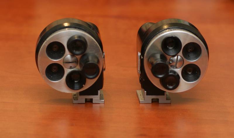

I tend to agree. If you want a universal finder then the one above shown is about as good as it gets for a Contax given these were designed for Contax / Kiev cameras.
But there are lots of options. If you do not mind using something less authentic for Contax, in terms of its ease of use (i.e. a very clear large view - the largest and clearest I have seen in any finder) I am kind of partial to the "Turnit" finder made for Voightlander Cameras. They come in two models - the early metal one and the later plastic one. I prefer the early one. Both models have views for 35mm 50mm and 100mm and the early one at least (I have not examined the later one) has a lever at the back used to adjust for vertical parallax).
