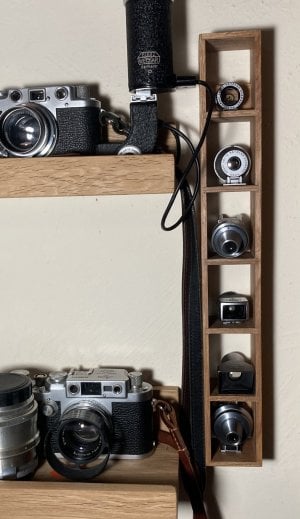

And on the storage note: a company here in the UK called Futon make these great trinket shelves, which are perfect for displaying your favourite finders and keeping them safe. The VIDOM sticks out a bit too far, but other than that: perfect.
