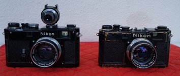

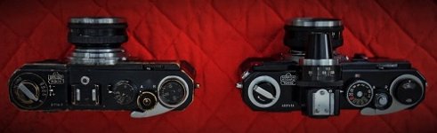

Nikon S2 black and Nikon S3 black
Hi there,
Nikon S2 black very early it's the second camera of the first round list
N°6170913.
Nikon S3 black N°6307454 in the pristine condition.
I take the pictures with these two cameras.:rolleyes:
Pierre from France
