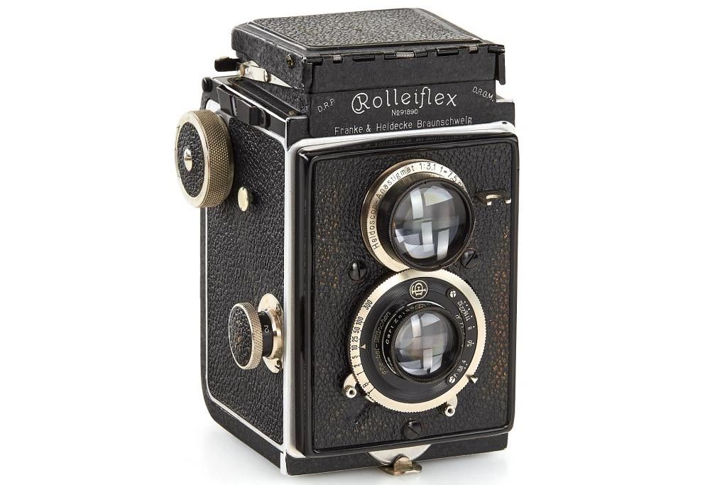

The original Rolleiflex
The original Rolleiflex was inspired by Franke & Heidecke’s Rolleidocsop (1926-1939), a roll film version of the company’s very first camera, the 6x13 cm Heidoscop stereo camera that took sheet film or glass plates. Conceptually, the original Rolleiflex is basically a 6x6 cm Rolleidoscop with one of its stereo lenses lopped off the side and the viewfinder centered above the taking lens. Production versions of the original Rolleiflex “K1” (models 611, 612, and 614) that were produced from 1929-1932 were all 6x6 cm TLRs that had uncoated 75mm f/4.5 or f/3.8 Zeiss Jena Tessar lenses, red window, knob type film advance, and manually cocked rim-set Compur 1-1/300 sec shutters. Unfortunately, they all took 117 roll film which uses a narrow flange spool similar to a 620 spool but has a wider keyway. To use one of these ancient beasts you’d first have address the spool problem either by obtaining (very rare) 117 film spools or re-machining existing 620 spools, and then re-rolling 120 film and paper backing (which is the same width) onto the spool in the darkroom. I’m not sure whether it’s possible to modify an original Rollei to accept 120 film, but if you did so it would certainly lower the value of your prized vintage classic. Verdict: The Original Rolleiflex is a great historic collectible but definitely not a convenient camera for taking pictures.
Original Rolleiflex, second model with 75mm f/3.8 Carl Zeiss Jena Tessar lens, courtesy The Leica Shop
