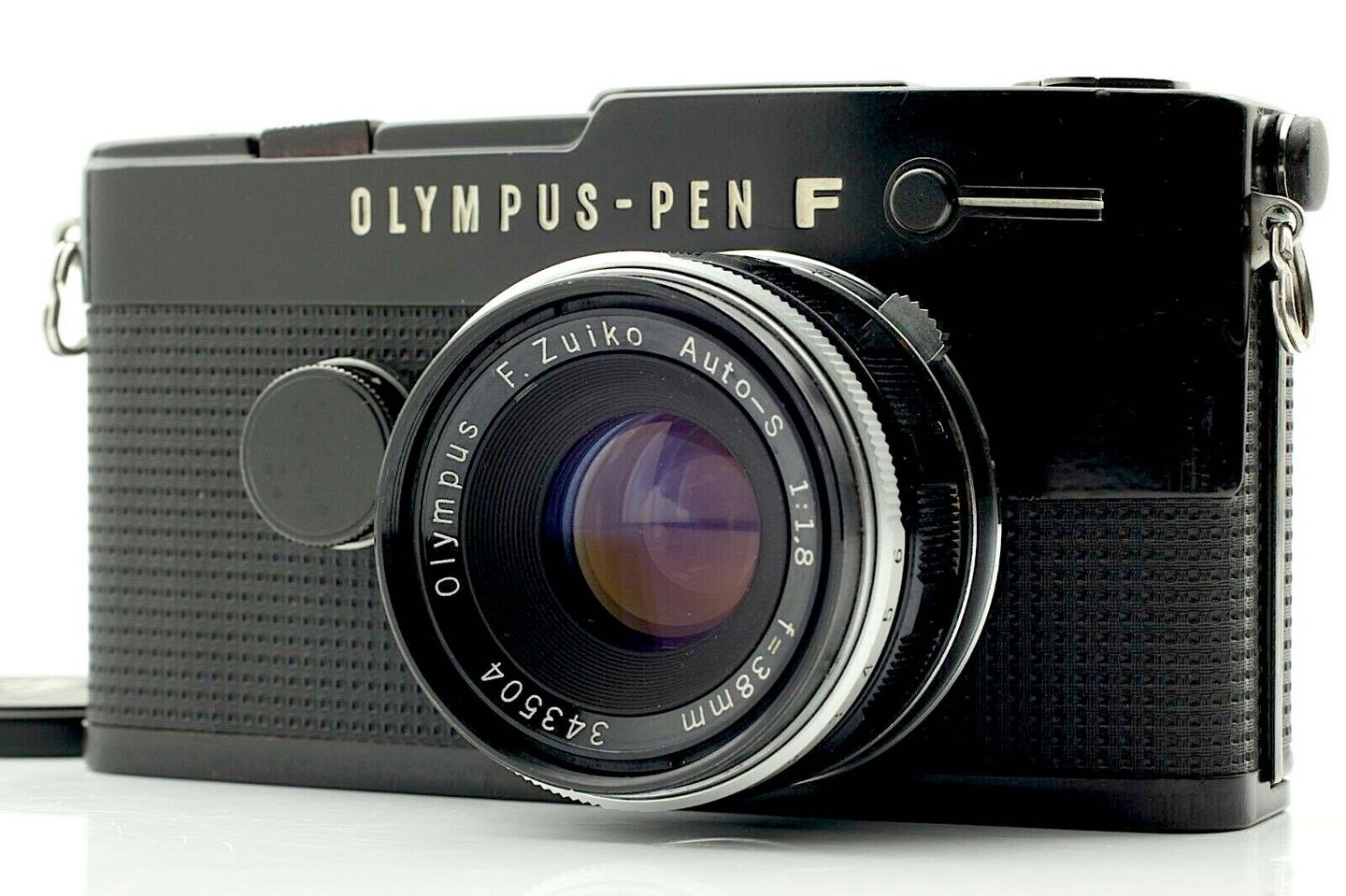

The original Olympus Pen F
The world’s first interchangeable-lens half frame 35mm SLR (18 x 24mm format) the Pen F was launched by Olympus in 1963 to complement the highly successful scale-focusing Pen line. Designed by Maitani Yoshihisa, the renowned engineer who had already created the Olympus Pen pocket sized point-and shoots and would go on to develop the landmark Olympus OM-1 and XA, the original Pen F is a masterpiece of ingenuity and compactness that incorporates a host of innovative features. These include a compact rotary focal plane shutter that uses a single low-mass titanium rotor to achieve a top shutter speed of 1/500 sec and X sync at all speeds, a brilliant porroprism viewfinder (an assemblage of highly reflective mirrors) in lieu of a solid glass pentaprism, and a sideways-flipping reflex mirror, all of which help to eliminate the traditional SLR prism bulge. The Pen F was also the heart of a comprehensive system that ultimately included a full complement of dedicated bayonet-mount lenses ranging from 20mm to 800mm, most incorporating depth of field preview buttons.
rs=w:1440,h:1440
Original Olympus Pen F with 38mm f/1.8 F. Zuiko normal lens.
The original Pen F, easily identifiable by a prominent gothic F engraved in gold on the front of the body, is roughly the same size as a classic screw-mount Leica. Like the original Leica M3, the Pen F has a two-stroke film advance which Maitani deemed necessary to wind the stiff shutter spring effortlessly. However, it was revised on the subsequent Pen FT and FV, both of which have longer-throw single-stroke wind levers that work with low effort and commendable smoothness.
The Olympus Pen F provides evenly spaced shutter speeds of 1-1/500 sec plus B via a non-rotating, front-mounted shutter speed dial, X sync at all speeds, a bright 0.8x (with standard lens) porroprism viewfinder incorporating a Fresnel lens, a hinged back with an easy loading system, a 2-sroke, 90-degree film wind/shutter cocking lever, and a folding rewind crank. The Pen F has no self-timer or built-in light meter, but an accessory CdS light meter was available that attaches to the shutter dial with a two-pronged bayonet mount and is operated via a milled ring on its underside. Note: the meter was designed for 1.35v mercuric oxide cells and must be upgraded to work with current 1.5v alkaline or silver oxide cells. It’s estimated that about 190,000 half frame Pen Fs (not to be confused with the digital Pen-F introduced in 2015) were made over the course of its production run from 1963-1966.

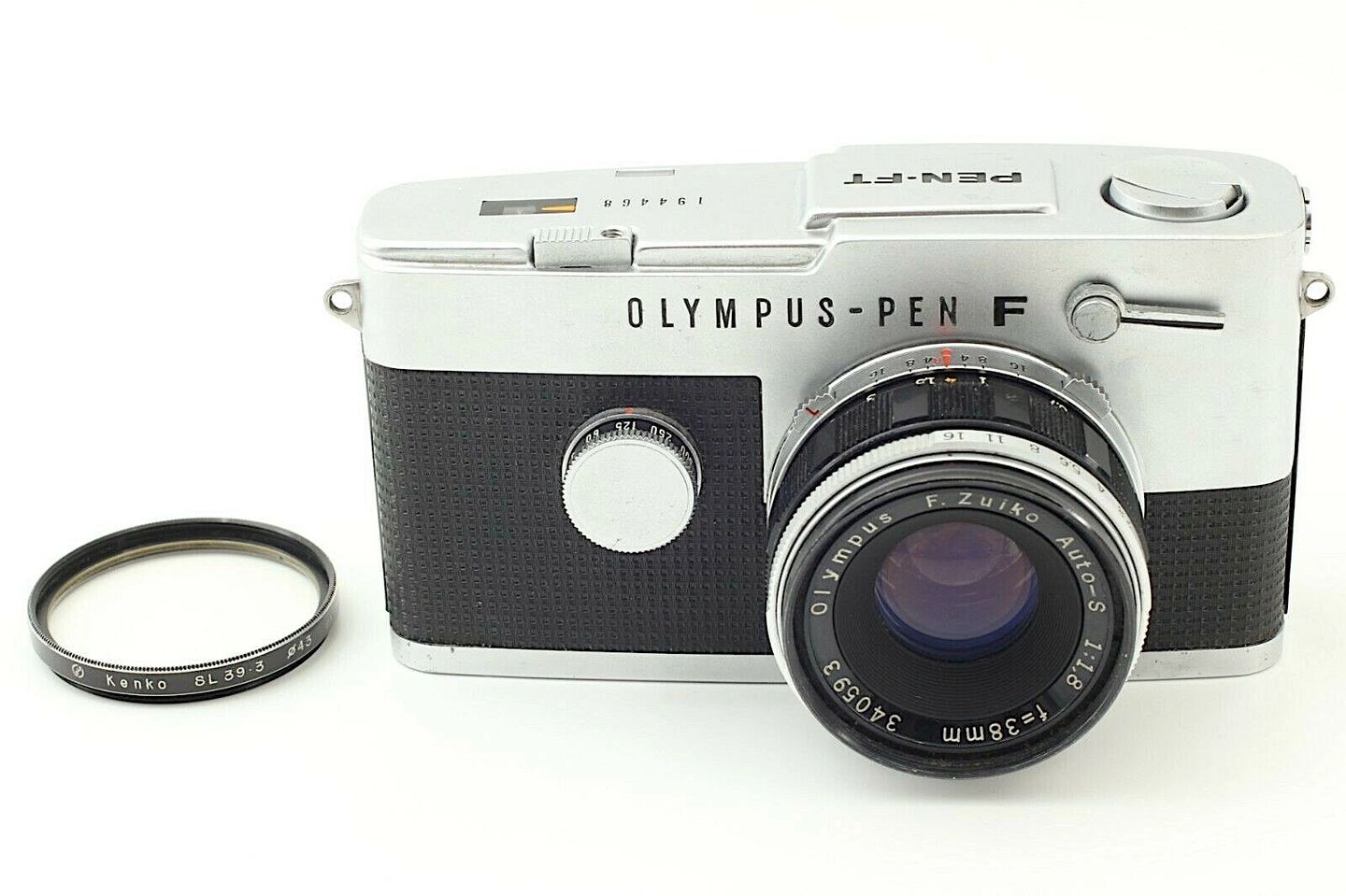

Olympus Pen F with accessory CdS meter attachment installed.
The bottom line:
The Olympus Pen F is the best choice for user collectors because its viewfinder is noticeably brighter than the one in the later Pen FT (which siphons off some light passing through the lens for its built-in TTL metering system) and it’s easier to focus, especially in dim light. The average Pen F is somewhat less expensive than the FT—it’s readily available used in excellent or better condition at prices ranging from $150-$300 with 38mm f/1.8 F. Zuiko normal lens and $300-$350 with 40mm f/1.4 G. Zuiko lens. These cameras are generally quite reliable and lots of fun to shoot with, and both the f/1.8 and f/1.4 normal lenses deliver outstanding imaging performance. Indeed, all the Olympus Zuiko lenses in Pen F mount are superlative, and while the rarest and most coveted examples command princely prices, they’re still one of the best reasons for anyone getting into the world’s most compact 35mm SLR system.
