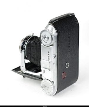

I have an early Bessa II (1948 model) with one square and one round window, like this one:
I was wondering if the later models with two square windows like this one:
have better, brighter viewfinder (by comparison). Also how much better is the post 1951 Synchro-Compur? I'm thinking of trying out a few different Bessas. Especially the Skopar as I've only ever used the Heliar.

I had one like this. The cold shoe is a separate "snap on" shoe made by Bessa. I doubt the VF is any better between the square and round windows - the view was typical for many cameras made in this time frame. I used a Leica 50mm VF in the cold shoe. Both 35mm and 6x9 film sizes have the same ratio of length vs height (1.5) so a 50mm VF perfectly frames the shot.
The viewfinders will be the same more or less. The VF quality depends on internal condition. The Apo Lanthars are rare and usually fetch higher prices, followed by Heliars, then Skopars, considered the low end. Shutters are are not to be trusted regardless of how they sound or price. I find that the Rapid and synchro shutters are usually slow at 1/400 and 1/500, and likely also slow at 1/250, unless they have been competently overhauled. I wouldn't touch one unless the source was reputable. Bellows same, not to be trusted unless source is reputable.
