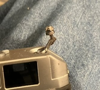

This is an old thread but I broke this crank on a brand new Rollei 35 RF, made by Cosina. I was able to CAREFULLY drill and tap a 4-40 hole and use a shoulder bolt screw which works, but the material is not much to work with. At least I can use the camera. If I had the insane money to purchase a Zeiss 40mm f2.8 that body might be worth the cost. I do indeed love the camera however. I can post a picture if anyone is interested. I should mention that I first had to carefully bend the tip of the crank in order to get the screw hole drilled. I only had simple tools
I know that I should have bent this piece a little bit more but I was cringing. If I had a pair of small needle nose Channel Locks I might have been able to. I was reluctant to ask a friend because if the piece broke in two he would have been horrified

But for a small part like this knurled knob a "good friend" with a minilathe should solve the problem.
I did a bit of searching online... the original crank handle seems to be made of plastic. The axle is pushed through and - apparently - riveted.
The "underlord" method seems to me to be the most durable. A small crank handle made of metal and corded. A small screw pushed through from below and glued in with threadlock. This should last for a while.
You "could" also 3D print the handle yourself or machine it out of plastic.

I 'fixed' my R2 with a small knurled knob from a pocket knife blade. I was pretty pleased with myself, ten years ago when I made the repair! Looking back now I probably could countersink that small screw.
