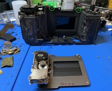

I recently bought a Bessa R from ebay stating it had a jammed shutter. I took a gamle hoping I could repair it. It had the same issue (only 1 shutter triggering). I was lucky amd managed to repair it. Removed the bottom plate, removed the metal pice attached to the rewind ratched that cocks the shutters. Beneath that I found a small springlever that had slipped out of it's recess and also beneath that some old dried grease that was hindering the trigger mechanism from resetting (it couldn't fire the second shutter when out of alignment) removed a bit of the dried grease, put a tiny bit of watch oil and reset the spring and voila everything works perfectly again 👍

The Bessa series is mechanically very similar (and with regard to the shutter mechanism, probably identical) to a number of SLRs -- Nikon FM10, Olympus OM2000, Vivitar 3000(?) manufactured by Cosina. So there may be information out there about servicing the shutter for those cameras that should be equally applicable to the Bessa R, Bessa L, etc.

That is great information 👍 my biggest problem is actually getting the thing open 😂 I'm lucky I was able to repair it by just accessing the bottom plate. I tried removing the top plate but it feels really iffy putting any force on the top plate without risking to break the plastic. Otherwise I'm pretty blessed with an intuition of just looking at mechanical stuff and see what is wrong pretty quickly. But would be nice with a service manual so I can do a proper cla...The Bessa series is mechanically very similar (and with regard to the shutter mechanism, probably identical) to a number of SLRs -- Nikon FM10, Olympus OM2000, Vivitar 3000(?) manufactured by Cosina. So there may be information out there about servicing the shutter for those cameras that should be equally applicable to the Bessa R, Bessa L, etc.

Repair: Voigtländer Bessa R (Part 1)
Hello, everybody! Do you believe in curses? Some folks believe that items can be cursed, it can come from the previous owner or just a stroke bad luck. You’…
Repair: Voigtländer Bessa R (Part 2)
Hello, everybody! Because of the generous support that I got from all of you, I am motivated to finish this series earlier than scheduled. I’m not saying th…

A good write up Richard. I've just been repairing one but it didn't need dismantling, just a broken rewind crank. I do cringe, though, when I see bits of cameras and screws spread over a bench. I like to keep the parts of each assembly along with associated screws together so I can be sure what goes where when reassembling.![]()
