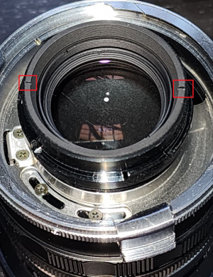

The spring loaded coupling ring on my lens is indeed misaligned. It seems that the notch circled in image 1 should be aligned to the indexing dot and infinity mark, based on my other S-mount lenses.

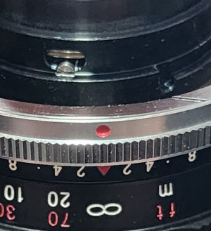

But the coupling ring on this lens is secured properly, and it does not rotate freely. There is a screw partially blocked by the ring itself (Image 2). I'm not sure if that's the screw securing the coupling ring or how I can access it.

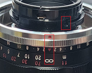

I also noticed that the position of the coupling ring seems to be mechanically coupled to the focusing ring itself. (Image 3)

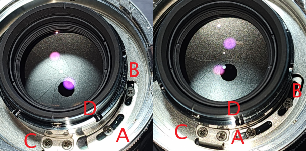

The screws A and B hold down a plate that rotates with the focusing and coupling rings. The notch on the coupling ring is marked as D.
Plate C functions as the infinity hard stop as it does not move and physically stops the focusing ring from rotating past infinity.
It looks like I could loosen screws A and B, and rotate the focusing ring to align the coupling ring with the indexing dot.
Essentially by moving screws A and B slightly to the right of their current positions. This should allow the notch to match where the indexing dot is.
But that would mean that the focus markings on the lens would still be wrong, as it will focus past infinity and be unable to focus down to MFD.
I'm also concerned that the 2 screws are also securing other internal lens components, and I could be destroying the lens by loosening the screws.
Or maybe I'm misunderstanding the situation entirely.

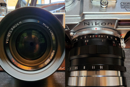

Just an additional thought, realised I'm not too sure what the retaining ring you mentioned looks like.
Does it refer to the ring with the 2 notches in the attached image?
It's tight on my lens, but did you mean that I could loosen this ring to reposition the coupling ring?

Yes that’s the retaining ring that I was talking about. When it was loose on my lens the coupling ring could be repositioned easily.
