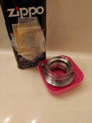

Yes, lighter fluid works! Thanks a lot! I'm very happy!😊 I was able to take out retaining ring on the back and separate lens block out of helicoid. After that it was half-submerged in Zippo lighter fluid for about 5 hours. Magic happened, using rubber gloves and great force focusing wheel slightly moved so I repeated the procedure for another few hours and focusing wheel turns smoothly now after applying a bit of synthetic grease. Never thought that lubricant which was used 60 or 70 years ago could be turned in form of sort of cement. Conclusion also for me if the LTM lens not in use for extended period of time never set it for infinity lock position. Thanks a lot again and Best regards!!!
