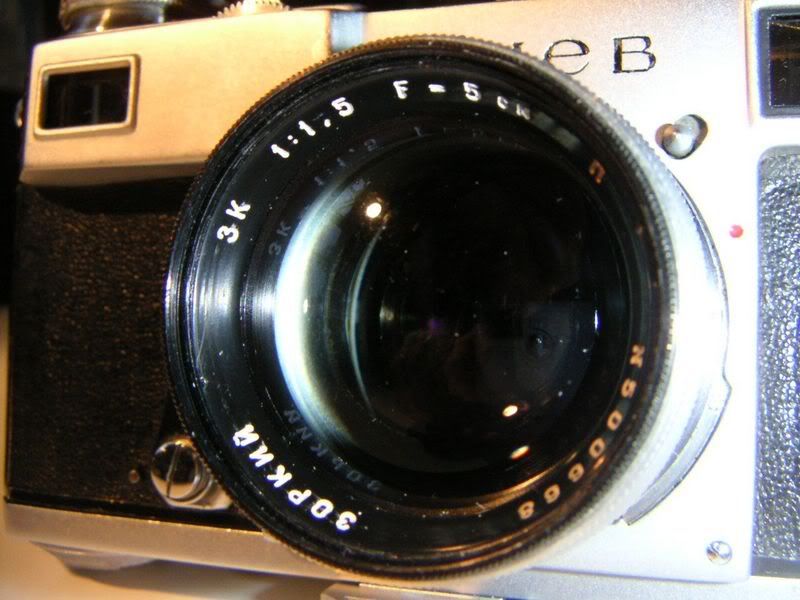

I did own a ZK for the Kiev, which I sold, of course now I wish I hadn't. At that time there were a lot of fakes around, which were usually obvious.
This one was real, altho it post-dates the Zeiss-produced glass, which apparently usually had a Zeiss number engraved on the rear lens group.
I still have the Kneb, complete with 1952 instruction manual...
