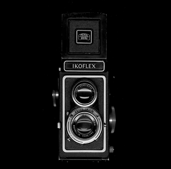

In my opinion the Zeiss Ikon Ikoflex cameras are excellent cameras with fine, Tessar 50/3.5 lenses.
Most of them are fairly inexpensive yet robust and reliable.
They have a red window start where the first film number is revealed in the red window on the bottom of the camera. At that point the film counter is reset and you forward the film until it stops. From then on the film advance is automatic. Not quite as classy as the Rolleiflex Automat but still pretty nice.
I agree with Pioneer's comment. I had an Ikoflex Ib for a few years and I liked it.
There are a number of interlocks and i found the film loading process a bit complicated. On the positives, you can unscrew the lenses with your hands and clean them in case there is fungus etc.. and you can clean the mirror easily.
As expected, picture quality was very good.
