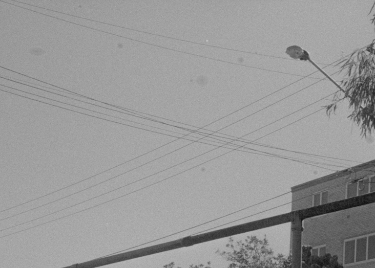

Does anyone know what this is? I have eliminated the scanner, the lens, and the developer. I suspect it may be from inadequate agitation, but I really don't know.

I was just mulling over the spots I've got on some negs I just developed and they look similar to Pioneers, but just less of them. I can't see them on the neg.. It's consistently across the last batch I developed yesterday, never seen it before...
The fixer/stop were a bit old? I've had them for about a month but not unusual.
The film got hot over late summer? This is before exposure and its always hot, so again not unusual.
Film was my usual Fomapan400@250 developed in LQN at 20 deg.
This is a crop, about 1/4 linearly of the film size.

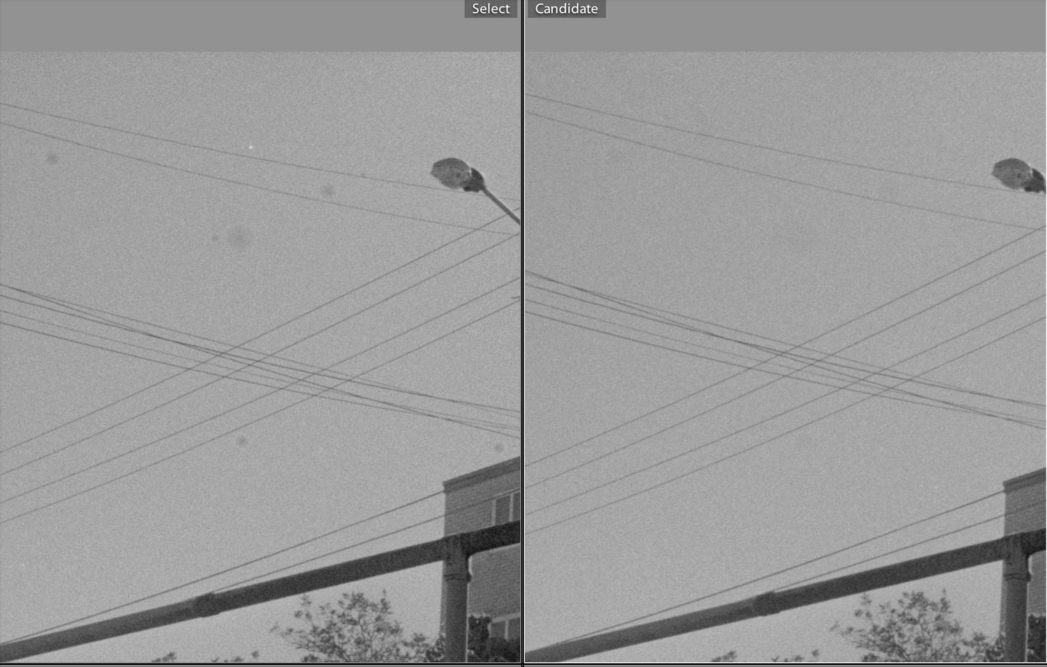

The issue for me is far reduced. I think with some more active washing the problem will be eliminated. Original on left, scrubbed on right.
If I think back, what I normally do is get a bit of dish washing liquid and put it into the final rinse, and in this case I remember there were more bubbles than usual. That I could scrub it off leads me to believe that it was some residue, even though it was not visible at all on the negatives - I don't have a magnifying glass though :)
Pioneer, can you try a real wash, rather than a rinse, and see if you can scrub it off? Ideally on a negative of no value (I possibly jumped too quickly to the conclusion that they're not all Pulitzer's). I'd be interested to see if we both simultaneously stumbled across the same f-up.
