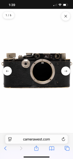

Well I decided what appealed to me was really a brassed black body and pulled the trigger on this iii from 1933. It’s on the way to me. Realistically I can put a wider lens on and scale focus more easily anyway. If a ia ever falls in my lap so be it.
