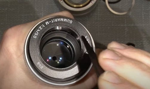

I was watching a video of the dissasembly of a Summarit 50/2.4, and in order to remove the nameplate from the front, the technician needed to pry it off versus unscrewing it. It's at the 10m30s mark here:
When did Leica make this change instead of using a rubber thing to unscrew the plate?

The f2.5 and f2.4 Summarit lenses were constructed like this to cut costs. They are also discontinued. So the short answer is they started in 2008 when the f2.5 Summarits were introduced. But a great majority of other Leica lenses I have seen pulled apart, including the current generation lenses, have threaded rings or no front nameplate ring (the wide lenses are mostly designed without space for a nameplate ring). So it is not consistent.

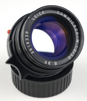

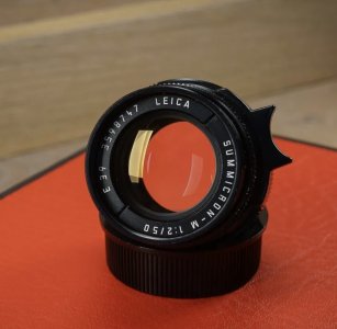

I also noticed a nameplate change on the Summicron 50mm v4 where the earlier ones had slots for a spanner to no slots. My casual observation is that this occurred with 50 Summicrons with 360xxxx serials (roughly mid-1992). But I suspect these still have threaded nameplates.

Thanks, I suspected it was a cost-cutting measure for the Summarits.
