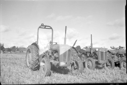

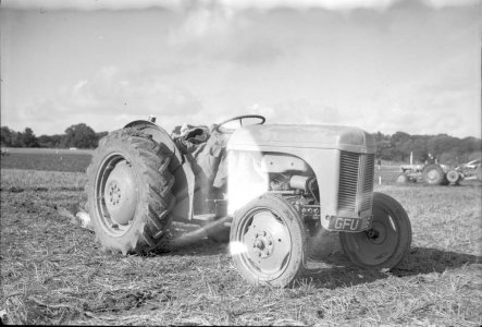

Where is this light leak coming from?

This occurs in every frame of the roll, density and number varies. As far as I can ascertain all the shutter blades open and close OK (it's not got the 800 shutter, so no capping blades to worry about).
Shots were all taken with the sun behind, there is a sprung cover over the red window so only open when winding film. My best guess is that there's some kind of internal reflection - any better ideas? I'm really peeved by this, it's a lovely camera that can obviously deliver decent results, but this damn leak spoils it!
Are all the leaves of the central shutter working really properly? Ore to specify it, if the shutter is closed, is it really completey fully closed.
Yes, when the shutter closes, there is no light visible when pointed at a bright source. I've edited the OP to reflect this.
I am thinking that in both shots the most intense area of leakage is low in the frame, conceivably where the red window is, and the bigger leak is brightest* closest to that leak, and gets darker further away - so light is entering the camera where the leak is brightest (stating the obvious - what I'm trying to say is that is telling me which direction the light is coming from)
Over the years I've got into the habit of winding on after taking a shot, but not winding right to the next number, so when I look I can see that I've taken a shot and need to finish winding on. This also means, I hope, that the film is tight as I wind on fully to the number after I open the bellows. I think this explains the double leak in some pics.
So these would have been wound on with the sun over my shoulder, into the window - Delta 100 doesn't have particularly thin backing, does it? It's many years since I've had issues there - even with Portra where the markings are so faint I have to let bright sun fall on the window so I can see the numbers! All this makes me think red window, as does the curved shape of the leak which looks like the edge of the internal flap that blocks the red window (and, incidentally, makes it a bugger to wind on because of how you have to hold it)
But how and where? I can't see a bright spot that might reflect light, and the pressure plate actually has a felt pad behind it.
OK - I'm going to have to dive in with a bright light, I think, apologies for all the rambling above, but it helps me get my thoughts straight.
*in terms of the positive

My guess -- truly a guess -- is the leak will be at some point to the left or right of where the bellows joins the film body. The leaked light will be striking the film from the front side of the camera, when the lens panel is open, at some point where the film is outside the film gate. That is, at some point either before or after the film frame is in position for exposure.
Although at first glance the shape and position of the leak would suggest some association with the film number window, the film backing paper will mitigate this. Also, the film number window on this camera will be offset from the center line, while these leaks appear pretty much centered.
It may be possible to detect by going into the dark closet, allowing time for your eyes to adjust, then shining a bright led flashlight around all joints between bellows and body.
Whatever you find, I hope you are able to get this sorted. The sample images you have posted show the results will be terrific!
Hmm. Light tests (had to wait for darkness, I don't fit in the wardrobe!) do show pinholes up the corners, which have been smeared with liquid electrical tape, but I don't believe that explains the regularity of the shape. Once the tape has had a decent time to dry I will investigate further...
This is the album with them all in - some (eg scan0006) definitely at least partly the bellows, but that doesn't explain the big one.
